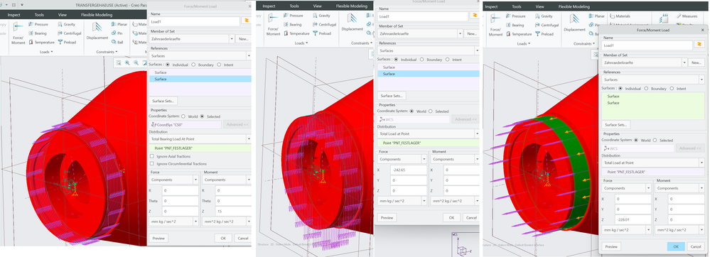

In this case, we have a two-stage gear assembly where intermediate gears (3 & 4) are mounted on a transfer housing. This transfer housing is fitted onto a stationary shaft, which is supported by two bearings. The stationary shaft itself is aligned on two holders, also using two additional bearings.
The current arrangement of the outer single-row bearing is causing a preload on our transfer housing. This preload is transmitted from a sleeve to a nut and then to the inner single-row ball bearing, which functions as a sliding bearing. The other bearing on the transfer housing acts as a fixed bearing.
The purpose is to optimize and reduce the weight of this transfer housing, so the analysis is supposed to be done only on the transfer housing.

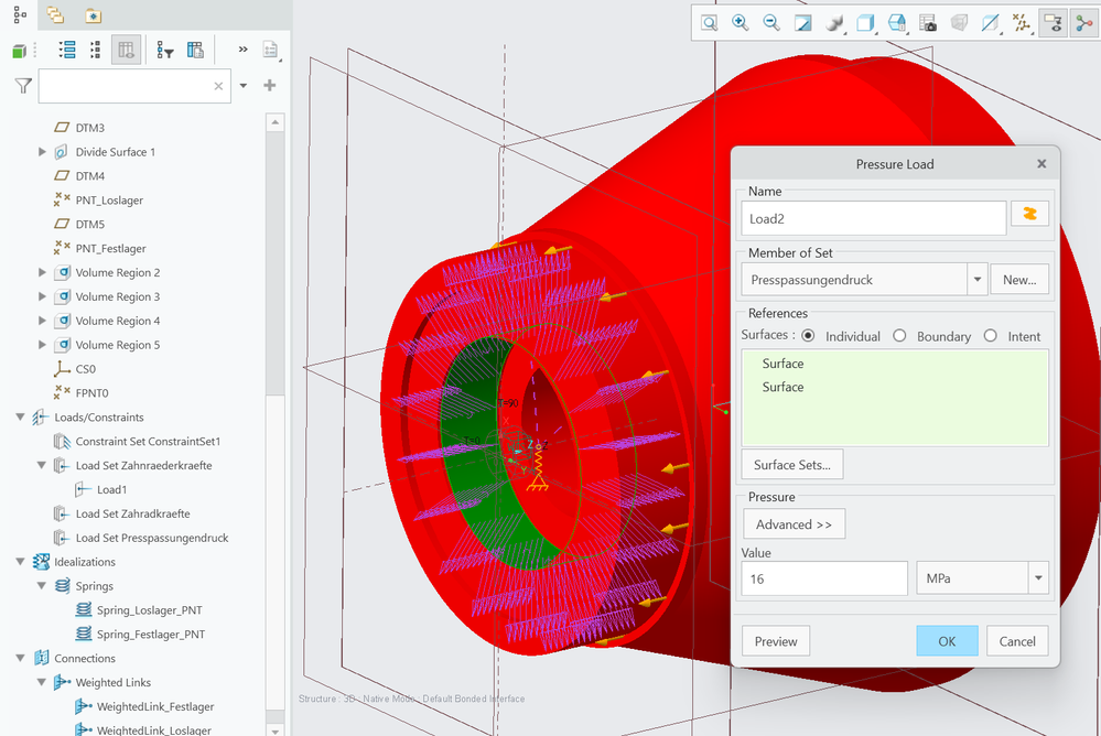

The calculation of the gear forces and fitment of bearing and gears on the housing is as below. But the problem is when I define force on one tooth, should I define contact interference or I just omit the teeth and consider a disk with pitch diameter ?
the other question is for the definition of the fixed and sliding bearing I idealize a point as an infinitely stiff spring (Point-surface) and connect it with the weighted link to the contacting circumference area of bearings and housing, but after that for the fitment pressure from bearing I exert the force on this same surface or it is wrong ?

Fitment Pressure for gear 3: 14.39 MPa
Fitment Pressure for bearing C: 30.15 MPa
Fitment Pressure for gear 4: 7.79 MPa
Fitment Pressure for bearing 😧 33.29 MPa

You can exert radial [Fr] and axial [Fa] forces on the ring surface with the width of the gear that is in contact with the rotating component using WCS direction. and separately place a Moment based on Ft exactly like the picture ?
and the other question I have is when i define the bearing I idealize a point as an infinitely stiff spring (Point-surface) and connect it with the weighted link to the contacting circumference area of bearings and housing, but after that for the fitment pressure from bearing I exert the force on this same surface or it is wrong ?

I would not dispense with the gears, but introduce all 3 force components at the tooth, otherwise something might be lost? For example, the axial force on the tooth generates bending moment etc. Then the units are not optimal, better Newton basis. I would simply consider the bearings as you intend for the optimization. At the end, however, when the geometry is fully optimized, calculate with real bearings for checking purposes.
Ich würde auf die Zahnräder nicht verzichten, sondern am Zahn alle 3 Kraftkomponenten einleiten, sonst geht vielleicht etwas verloren? Z.B. die Axialkraft am Zahn erzeugt Biegemoment usw. Dann sind die Einheiten nicht optimal, besser Newton Basis. Die Lager würde ich so wie Du vorhast für die Optimierung einfach betrachten. Am Ende aber, wenn die Geometrie fertig optimiert ist, dann mit echten Lagern rechnen, zur Kontrolle.
