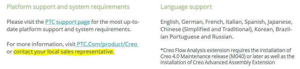

Considering that the CAD model of the robot is designed using PTC Creo, and considering that recently PTC has introduced a module for flow analysis [3], we would like to run such simulations directly in Creo.
The only problem is that so far we didn't find a document or a video explaining how to get the lift and drag coefficient and the center of pressure.
Here the questions:
- Do you know if it is possible to get the lift and drag coefficient and the center of pressure for external CFD?
- Do you have a link to a document that explains how to run such simulations?
- Which package (basic, plus or premium) should we buy?

Hi
For the package, if you only have external fluid dynamics problems. You only need the basic package, that includes flow, turbulence, heat transfer and all post processing tools. The setup is very straightforward. Most of external fluid problems,  we can get the converged solution in couple minutes. We can also show the results in the real time during the calculation.
