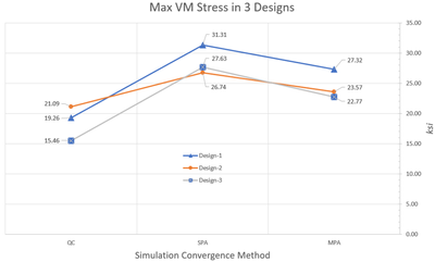

Good morning, I ran stress analysis on 3 design options with 3 different convergence methods. The maximum stress results are shown in the diagram above. How to interpret it?
1: Design-3 is the best?
2: Never trust Quick-Check (QC) and Single-Pass Adaptive (SPA)?
3: Always run Multi-Pass Adaptive (MPA)?
Thanks.

Design-2 is the best if using the data from SPA. Design-2 is the worst if using the data from QC.
