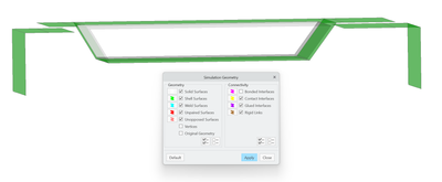

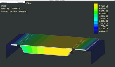

I'm just frustrated about very primitive exercise in Creo Simulate 12. See the sketch below. In creo there is an assembly contains 2 composite parts, in real glued together. The cored composite board (composites 1) is bonded on composite frame L profile (composite 2). The target is to see how the rigidity of L profile affects the modal frequencies of board.
Only composite quilts are supported in Simulate, it means the virtually gap is observed, the layup guilts are not in touch, bonded connection is not supported in this case. I have tested a lot of procedures, rigid link, spot weld...etc., but only bonded interface is closest to real surface - surface bonding.
Another test I have made, in assembly the 3rd part - glue was created, the thickness was a gap, but there is a material interference - glue + laminate in real.
Does anybody have an idea how to fix that? What is the correct connection feature between two composite parts, or generally between two shells?
Thx a lot, Rosta

Hi, Great question!
The correct way is to make sure of bonding using review geometry.
HOW?

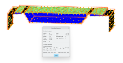

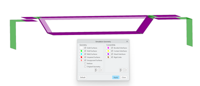

1. Use thin solids made shells with shell pairs. Do not assign the shell property to just a mid-surface quilt.
2. Make sure default interface is bonded, or define the desired interfaces-bonded.
3. Apply the laminate shell property to one side face(s) of the thin solid. The property will be transferred to the midplane. Note: Loads and constraints on shell pairs are also transferred to the midplane.
4. AutoGem will show the bonding elements.
5. If you want to see the bonding elements in the results, turn them on.
Note: the "core" was modelled as a thick solid part, with a wrap of laminate.
Also please refer to the last note in this help page and further pages on bonding elements linked from there.
It is all about a subtle wording difference between "shell", and "shell pair".
-Please mark this as a solution if this is the correct and best answer. Thanks!

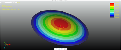

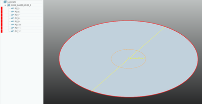

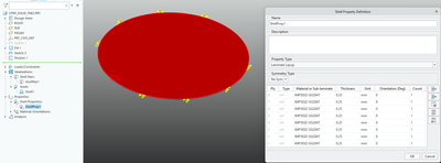

BUT!!! let's make an easy comparation test: Circular quilt D=400m, no assembly, no gaps, just one quilt, just one material definition, just one laminate layup, just one mesh...
TEST 1: Creo Composite layup, stack 8 layers = total THK 2mm, static analyse, max_disp_mag=1.55mm

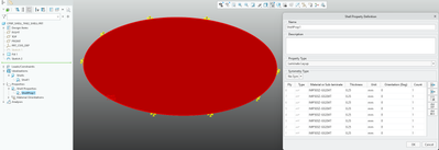

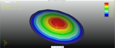

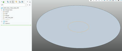

TEST 2: Creo standard quilt, no composite feature, constrains and load all the same from test 1, shell properties stack 8 layers = total THK 2mm, static analyse, max_disp_mag=3.05mm

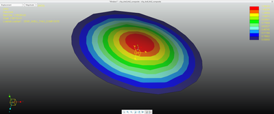

TEST 3: Creo standard solid THK 2mm, no composite feature, constrains and load all the same from test 1, apply your procedure above - shell pair definition, shell properties stack 8 layers = total THK 2mm, static analyse, max_disp_mag=3.05mm
Any idea why?
However, the test 2 vs. test 3 confirmed your procedure based on shell pairs.
