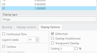

Could someone explain "scaling" in the display options when viewing simulate results? If it's kept at zero is what's displayed a realistic deformation?

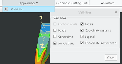

In Display Options, for 1X scale put scaling 1.0 and uncheck the %. Also, the scaling factor is shown in the results "labels" field.
