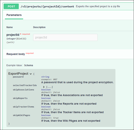

Can we do "Export project as Template" using API ?
SJ_7748282
7-Bedrock
Can we do "Export project as Template" using API?
alfonso_c
(To:SJ_7748282)
Hello @SJ_7748282 , yes, this is possible, you can use the POST /v3/projects/{projectId}/content endpoint:
Note that I tested on 2.2.0.0.
2 REPLIES 2
alfonso_c
(To:SJ_7748282)
Thank you for taking the time to help me out. Your solution was exactly what I needed!
