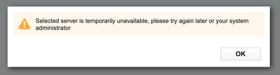

I am working on Codebeamer DPT links, I am able to create the link with another OSLC server but when I click on the Link object there is an error :
I have found Codebeamer is appending &_=<13Digit_Number> to the uri.

Thank you for your response, I am connecting to a custom OSLC server, I added CORS settings in Codebeamer and can create a link. but when I click on the link object it throws an error.
