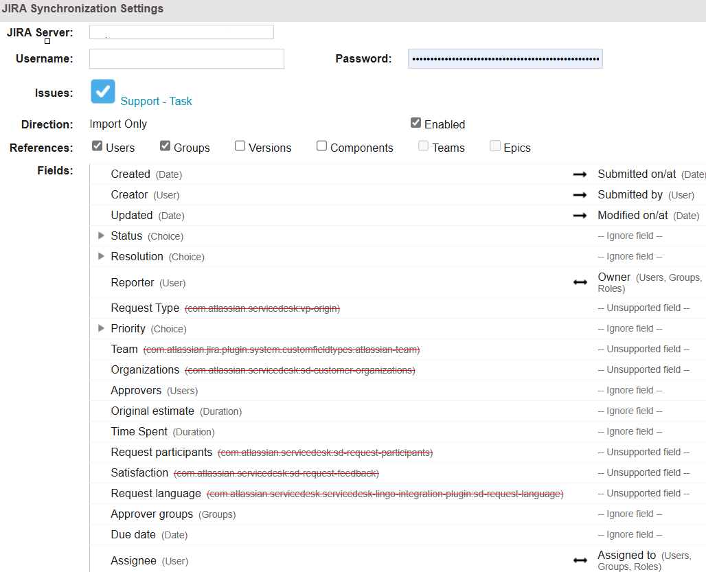

Codebeamer Jira field Mapping
I have synchronized Jira with Codebeamer and have mapped some relevant from Jira to Codebeamer. But I am facing issue with two fields, Assignee and Reporter field. While mapping I can't see the option to map Assignee field of Jira to Assigned to field of Codebeamer.
Anyone has any suggestions on the following above scenario, please let me know.
Solved! Go to Solution.

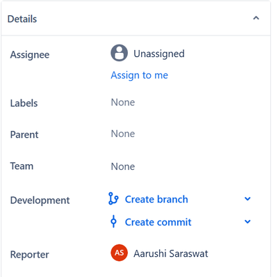

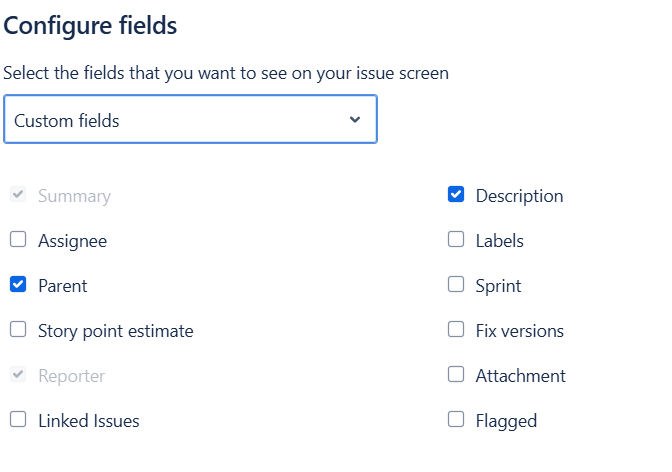

Hi @AarushiS ,
Could you check if you have the corresponding custom fields active in your Jira project, when you create a new Jira issue?

Hi @cristina.b, I just created an Issue in Jira of Task type and could see Assignee field has 'Unassigned' value and Reporter field has 'Aarushi Saraswat' as me who as reported the issue.

In the tracker's Jira synchronization settings, are the Users and Groups options selected?

I see that in the Synchronization settings, the Users and Groups option is disabled and I am not able to select it.
How can I enable them ?

If you have administrator rights on both Codebeamer tracker and Jira project, you should be able to modify those settings. If you have the necessary access and are still unable to modify them, I suggest to open a support case, to investigate the issue: eSupport | PTC

I am able to see it now and configure them.
Thanks alot for your support.
