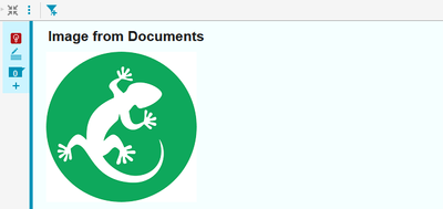

Hello everyone,
Is it possible to display an image present in the documents tabs within a description of tracker item? I can add the link option to the image but not display.

I think the question was more about Pictures from "Documents".
For example, this markup...
...renders a picture stored under Documents tab.
