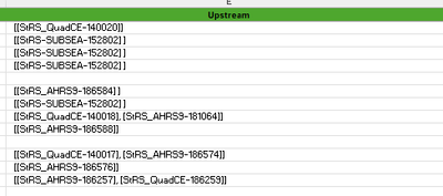

Hello everyone,
I am currently working on a Excel template and I wanted to replace ${item.subjects} whose format is [Key-Id] - Name.
Some issues appear when I import back the file and I want to avoid them.
I wanted to export my upstream fields in a format : [Key-Id] format.
(The format is the same as the one added when Work Item Key-IDs Setting in a tracker.)
Do you know if there is a command like item.id or another way to create this format ? It seems easy but I did not find any documention mentioning a list of command available for default fields.
Thanks for your time
Current viewExpected view
Hello @JF_12205541 ,
Try this formula for the value of column E:
[<jt:forEach items="${item.subjects}" var="upstream">${upstream.tracker.keyName}-${upstream.id}</jt:forEach>]
1 REPLY 1
