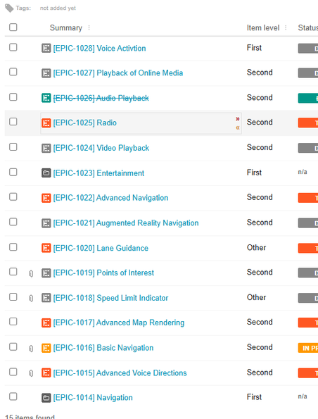

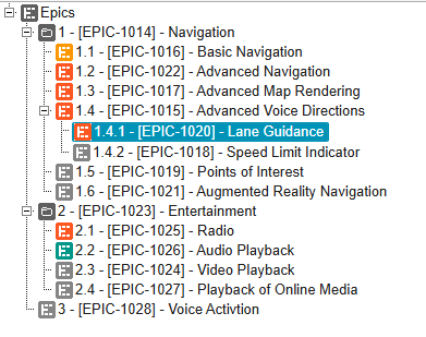

I've set a computed field with this formula: empty Parent ? "First" : (empty Parent.Parent ? "Second" : "Other")
This is the result:

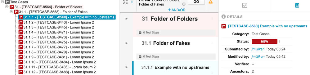

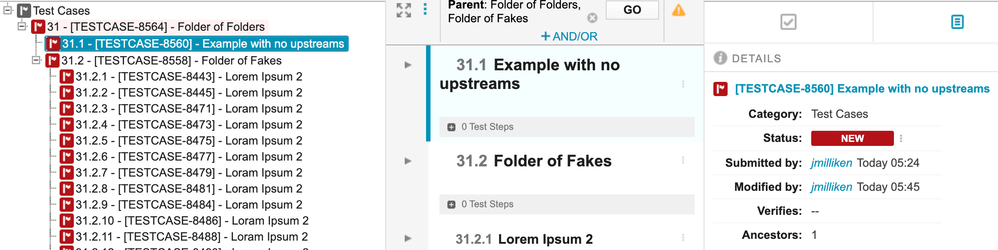

Hey, I was able to achieve what you were looking within a single tracker by creating a computed field with this expression:
empty Parent ? 0 : Parent.customField[1] + 1
where customField[1] is the property of my Ancestors custom field.
As you can see above, I've created two items as parents, and this example item with a parent that has a parent has a value of 2 in the Ancestors field.
 And now that it's parent has no more parents, the Ancestors field has a value of 1.

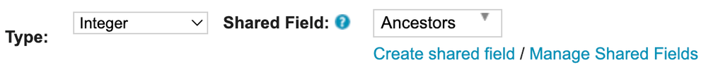

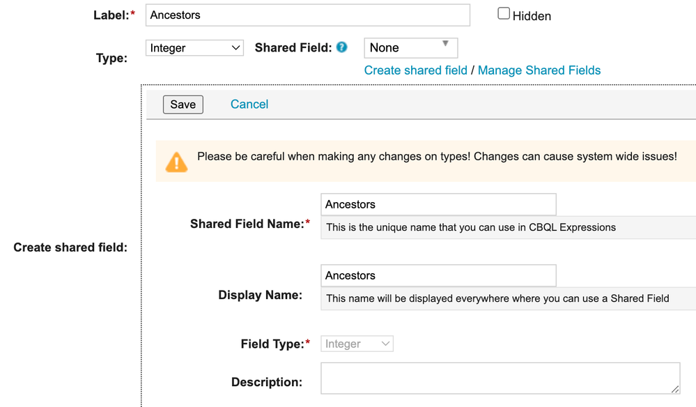

If you wanted this to work across trackers, or to be a bit cleaner of an expression, you could create an Shared Field for "Ancestors" and associate these individual tracker fields with this shared field like so:
Allowing us to use this new expression easily:

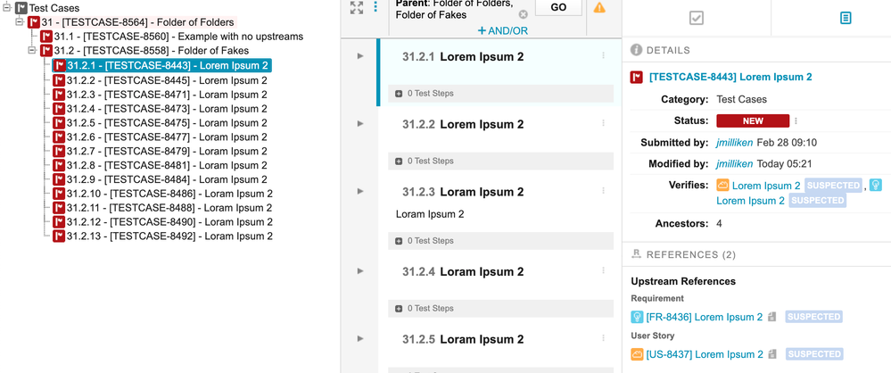

max(List(max(subjects.{subject | subject.Ancestors + 1}), empty Parent ? 0 : Parent.Ancestors + 1))
4-ancestors-across-trackers.pngFor this particular "Loram Ipsum 2" item, it has 4 ancestors - that being a User Story, with an upstream Feature, with an upstream System Requirements, with an upstream Customer Requirement.
This works within a single tracker as before by traversing the Parent, but also works across trackers by finding the max of all the Ancestors fields in the subjects tracker.
If you had other upstream trackers to include, it would only require an adjustment to the formula to include them in the max function.
