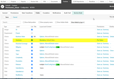

yes, if you go to the Tracker configuration, Fields tab, you can find the Permission column, there you have to select Per Status permission, and then you can define, in which status, what role have what permissions.

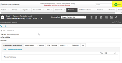

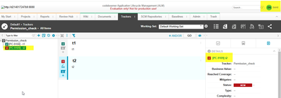

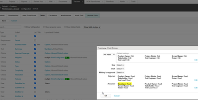

I made the following little test:
I created a user called test1.
I added it to Developer role:
I created a new tracker called Permission_check.
I set the Summary field permission in that way, that Developer role has only Read permission in Accepted status and nothing in other statuses.
I set all other field permissions to Same as Summary.
I created 2 items in the tracker and set one of them to Accepted, the other remained in New.

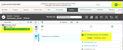

I logged in with test1 user in an incognito window and checked the content of this tracker and saw this:
and saw this, when double clicked on item 9109 in the left tree
I hope it helps!
