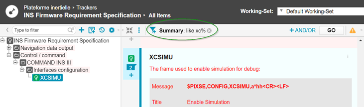

In a tracker of requirements, the filter doesn't work with wildcard:
  1. for a key like this "XC%":
    1. The engine find "XCSIMU" (ok), but it doesn't find "XC_DEBUG_SRC" (NOK)

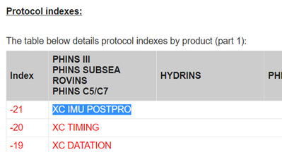

  2. If we do the same thing with "description" field, the result doesn't contain results with de keyword inside a table (same key):
    2. I don't see the requirement wich contains this table with "XC IMU POSTPRO":

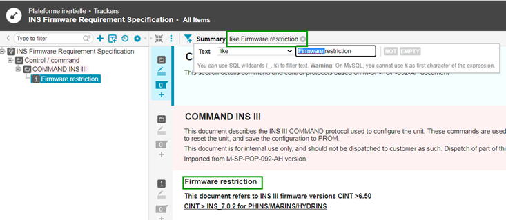

    4. Moreover search for a full title works witk "like" operator, but search for a work in a title doesn't work:
        Doesn't find "Firware restriction"

the filter works with version 2.1.0.3 (mysql). But the warning message below seems to be useless because "%keyword" works:
  1. the warning message is not true: Amaury_0-1725007517330.png
    MySQL however supports the % character at the start of an occurrence:
    https://www.w3schools.com/mysql/mysql_wildcards.asp:
    1. (WHERE CustomerName LIKE '%a', Finds any values that ends with "a")
