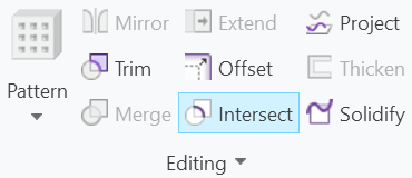

In order to create an intersection curve, we therefore cannot use the Body Boolean operations feature, but will use the “Intersect” feature within the “Editing” group.

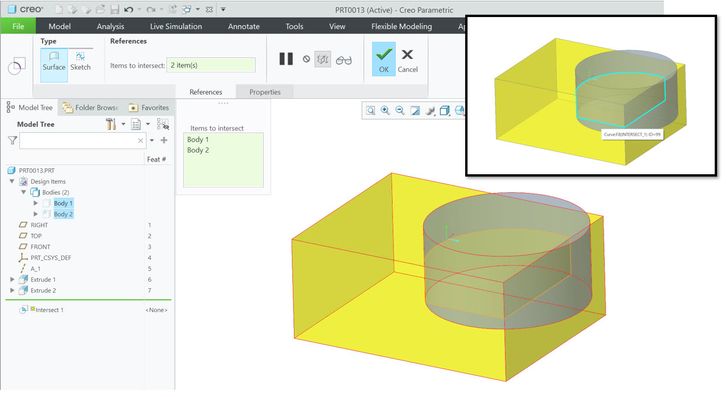

Starting with Creo 7.0, this “Intersect” feature allows to select bodies as references.
In this first example, we select Body 1 (yellow box) and Body (grey cylinder) and get the full intersection curve as a result. This is illustrated in the image below. (Result is shown in small overlay image)

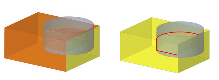

Note that you could also select just a single body in combination with one or multiple surfaces to get a partial intersection curve. In the example illustrated below we create the intersection curve based on a selection of the grey body 2 and 2 selected (red) surfaces of the yellow body 1.

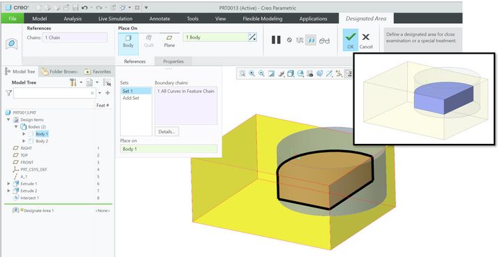

Intersection curves allow for a fast creation of a quilt representing the surface contours that are covered by the intersection (in particular for closed curves). You can for example use the curve generated in the first example as input to create a designated area. The image below shows the “Designated Area” feature with the closed intersection curve as input when placed on the yellow Body 1. The resulting quilt is illustrated in the small additional image.
Starting with Creo 9.0 and higher you can also divide/split these surfaces based on those curves.
Watch the video below to see an example use case of this.
