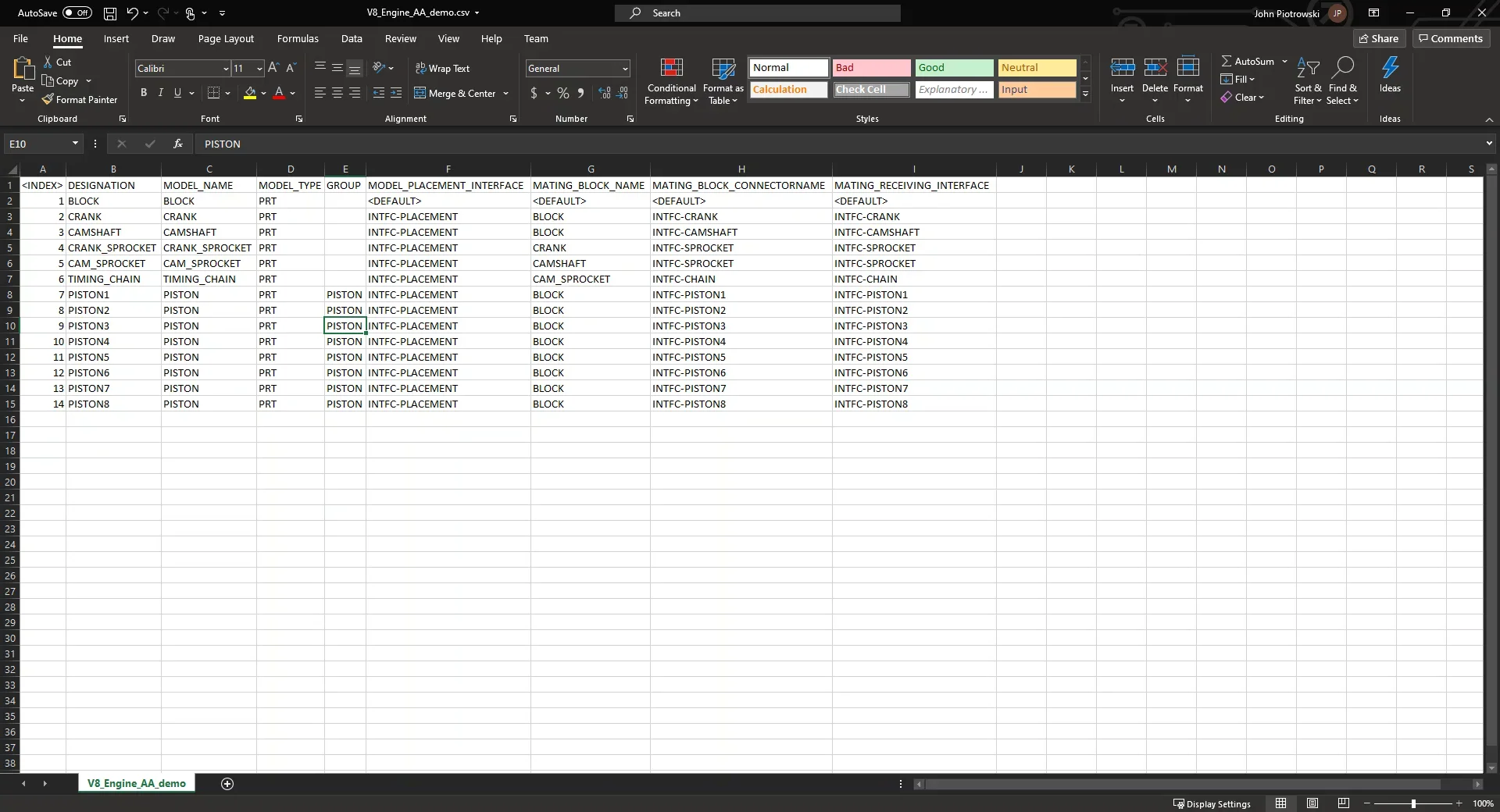

PhilatCADActive
(To:J0EL)
@J0EL
We can help with this! We offer a tool that automatically assembles models from some input file.
Here is a 2 minute video showing CadActive assembling a V8 engine block: https://vimeo.com/454511001
DM me if you would like to learn more.
Thank you!
This video shows a V8 Engine Block being created from an Excel input file, functionality that is now a part of CadActive&rsquo;s Automate package.

J0EL
(To:MartinHanak)
Thank you Martin, this is going to work best for me since I can programmatically generate these.
YES - there is a limitation on the amount of data that can be processed with the FREE version of Nitro-CELL
But for most circumstances, the FREE version is quite useful and can be easily mastered 3-minutes at-a-time with all the video help available online - over 270 of them to watch as examples / overviews.
Many customers alter their workflow to setup multiple executions to process larger amounts of data.  You can always request a FULL working Demo License to completely vet out your automation needs - and obviously we hope that leads to a purchase (multiple duration options through the software).
Oh... Don't forget CREOSON (Open Source Creo Automation) is out there - which has no limits if you are looking to code something in your language of choice... That is much better option than Trail Files (more control - the ability to introduce logic into the process).
Hope all of this is helpful ... Best of Luck!
