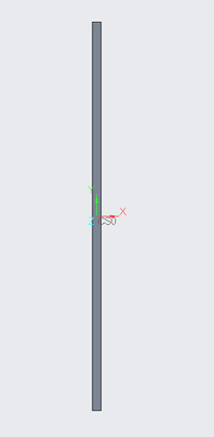

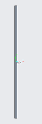

let's follow with normalization:
that is a view I'm getting when i input any kind of matrix. Even normalized
this is view it has to give to me
i suspect i'm getting some kind of generic view in camera coordinate system so it doesn't thorow exception even if matrix is invalid

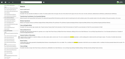

Let me start with documentation citation for JS API for CREO.
in Creo JS there is no mention about normalization of a matrix at all i'm not againt normalizing matrix but it would be good to know when using this kind of functionality.
Second thing from documentation which is not coinside with data you've provided is that your data provided says that you need to input matrix
When CREO JS API documentation says that you need to provide pfcTransform3D

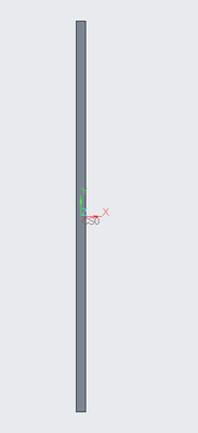

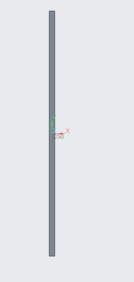

which result view :
Now let's try to uncomment inversion of pfcTransform3D and insert to the function new matrix
0.0	1.0	0.0	0.0
0.0	0.0	1.0	0.0
1.0	0.0	0.0	0.0
0.0	0.0	0.0	1.0
which results:
Those two views are absolutely identical.

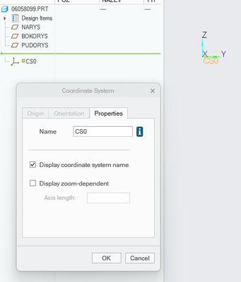

How is the displayed csys created? Please test with a default csys as a first feature. Did you refresh the window?
Here I answered a similar question
ilyachaban
(To:RPN)
displayed csys is model csys
model is freshly created only to test functionality of SetCurrentViewTransform
Same behaviour i see when creating insructions for drawing view create absolutely the same mistake
RPN
(To:ilyachaban)
If the csys is not the first feature it may have an initial transformation based on the first 3 datum’s. To see that the transformation fit, please create a csys as a first feature. Then compare your matrix. Else you have to multiply by the first csys transformation.
You can’t compare to the first csys, you may may dozen of them. That’s the reason to compare with the default.
