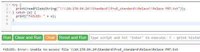

Hello, is there any possibility to read files from network drives?
try {
  print(readFileAsString("\\\\10.170.84.24\\Standard\\ProE_standard\\Relace\\Relace PRT.txt"));
} catch (e) {
  print("FAILED: " + e);
I need to read fresh relations so all models actual relations. The only one place in our company provides relations is network drive.

Result of using provided code:
Do you have web_link_file_read config option set to yes?
https://www.ptc.com/en/support/article/CS156638
Yes, I do and it works if I read from 😧 or C: drives. But when i reach out to network drive it can't read a thing
