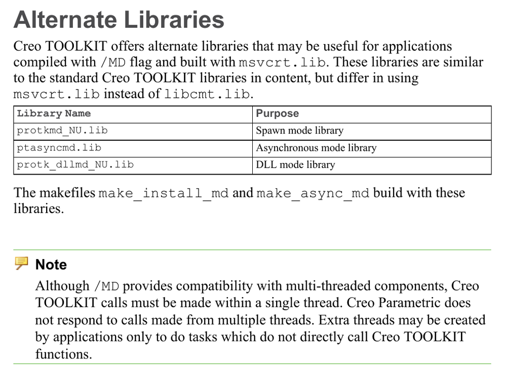

In case toolkit project, I think, no need to change flag to /MD.
For Release DLLs need to use "Standard libraries" /MT and remove flags for debugging (see below).
From Creo 9 toolkit documentation:
Today I read through the PTC article CS237146, where the six toolkit lib files are explained.
I noticed that I was misled by the "md" in the name of the protk_dllmd_NU.lib library: This "md" obviously doesn't mean that it is the debug version of the protk_dll_NU.lib library.
So I think this issue is over for now.
Thanks for your support!
