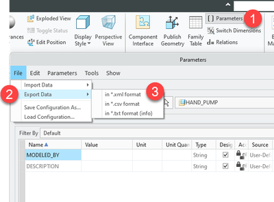

Seems like it would be easier to just use the FREE Versions of Nitro-BOM or Nitro-CELL.
Nitro-BOM: https://simplifiedlogic.com/nitro-bom
Nitro-CELL: https://simplifiedlogic.com/nitro-cell
tbl_parameter : GET https://www.youtube.com/watch?v=F4qF6WfbH8s
tbl_parameter : SET_CREATE https://www.youtube.com/watch?v=N_qImAQ9I34
tbl_parameter : DELETE (wildcard) https://www.youtube.com/watch?v=RTJsK43ftyM
