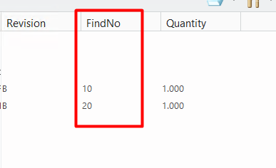

In our drawings we need to add the customized balloon that should call the parameter "Findo". Can you all please help me to get a solution?

The find number is a component/feature parameter. Just get all components and create the required parameter for this feature and assign the value you want. For Windchill the parameter should be designated.

I added the parameter in repeat region table, now I want to call that Find no string in balloon, I'm not getting how to customize the balloon

You must tell the tool which column to use for display. Check the menu options.
search community for custom balloons. I hope you will find the answer.

I got it, Thank you!
