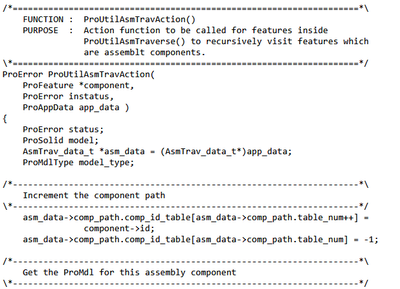

You should take a look at UtilVisit.c in the examples. Copy/paste ProUtilAsmTravAction(...)

I have see this post but I am struck in creation of visiting function for this API.
Can you please provide the visiting function for same.

You call the visit functions for components, if your component is a PRO_ASSEMBLY you just call your function recursive again.  It’s a little bit like traverse a folder structure. But for sure not the same.
An assembly is like folder, but this folder can appear at the same level or in other levels with the same structure and multiple times.

Use the function ProSolidFeatureVisit() recursively to collect components from all levels.
Example:
ProSolidFeatureVisit(Parent_asm, visit_action,filter_action,app_data){
    ProSolidFeatureVisit(child_asm, visit_action, filter_action, app_data)
                       .........logic
