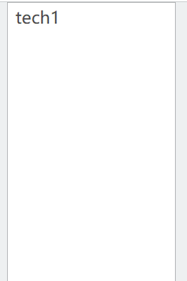

How to compose the tree data structure in Creo UI component Tree. I am using OTK Java.
With these classes it provide, I don't know how to add childNode or set parentNode. I can only display one node in the tree which might be the root node. This is my code.

      // 插入Tree节点
      TreeItem technique = uifcTree.TreeItemDefine("tech1");
      TreeItem step = uifcTree.TreeItemDefine("step1");
      TreeItem prt = uifcTree.TreeItemDefine("prt1");
      ItemPositionData itemPositionData = uifcCore.ItemPositionData_Create();
      tree1.InsertItem(technique,itemPositionData);
      step.SetParentName("tech1");
      itemPositionData.SetIndex(0);
      tree1.InsertItem(step,itemPositionData);
//      tree1.InsertItem(prt,itemPositionData2);
      uifcComponent.ActivateDialog (techniquetree_dialog);
    catch (Throwable e) {
      e.printStackTrace();
Can someone send me sample code about using the uifc component Tree?
