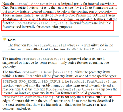

For free Java you can try this:
1. List all features.
2. GetIsVisible ()
3. Check a feature type (for example, to exclude not solid surfaces)
4. List sub items for the feature ListSubItems()
Are you listing items in asm or prt ? .. you can insert selected items to buffer to see in gui what edges are selected. If nothing help you can use macro to select edges through ctrl+f and then fire another macro (your command) to do the job.
it is in prt
ProGeomitemIsInactive(...) will filter out inactive edges.
But, IsInactive() method belongs to FeatureStatus object, which is in paid version of jlink, so you will have to do some workaround
2. GetIsVisible ()
