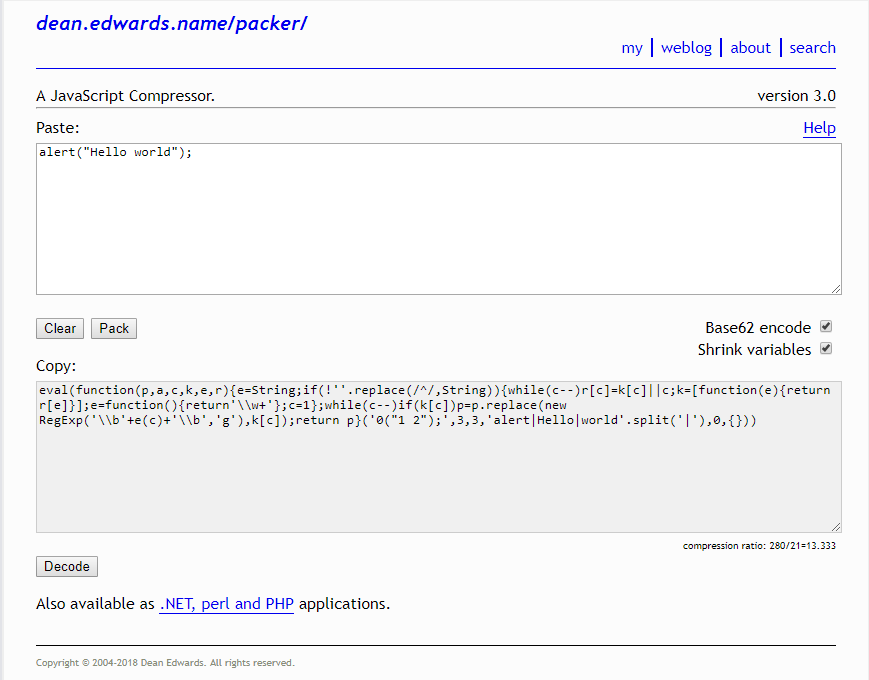

There are several ways to protect you code:
Creo API offers task based libraries. You can code some functions in another creo api e.g. jlink and then just call this function using weblink.
Option 2 (in my opinion better) is to obfuscate you javascript code. There are severals obfuscators available free. For example http://dean.edwards.name/packer/
You can achieve this (note this is just simple example):
But remember anyway you try to hide or protect your code, it will be always able to be reverse engineered.
