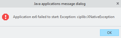

Hello!
Please tell me where to start.
I need to resize in a 3D model using J-Link
I loaded the class into the model, but it threw an error.
Best Regards.

please upload source code you want to repair. Also publish Creo version and java version.

Thanks for your reply!
Sorry to have provided so little information initially.
I read in the instruction manual that the code for the model needs to be loaded from the model itself.
Then I decided to consider an example for creo:
C:\Program Files\PTC\Creo 5.0.2.0\Common Files\otk_java_free\exercises\exercise_6
I compiled classes and put them in the creo working folder.
After which I wanted to add the class to the model as follows:
Pointed out the parameters of my class:
And got the following error:
Creo Version: 5.0.2.0.
Java version: jdk 11.
It seems to me that the error is not in the code, but in my actions. First I need to understand the following:
-how to run classes in a 3D model?
- What is the method for resizing a 3D model?
I will be very grateful if you show some simple example.
Best Regards.

I have a control question ... do you own Creo Object TOOLKIT Java license ? See Licensing for Creo Object TOOLKIT Java section on page 22.
Note 1: Unfortunately I have never set up a Model Program, so I can't help you.
Note 2: See https://support.ptc.com/appserver/cs/view/solution.jsp?source=Sitecore Article Viewer&art_lang=en&n=CS188737
Martin Hanák
Yes, but it doesn't matter, because I'm testing examples for OTK java free.
okay, thanks for the help.
