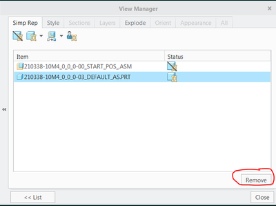

Today, I want to turn a mapkey, which exclude a part of an assembly from a representation, into a toggle where there is the possibility to include back the part.
Code to exclude the part :
mapkey ee @MAPKEY_LABELExclude the part from the representation;\
mapkey(continued) ~ Timer `UI Desktop` `UI Desktop` `popupMenuRMBTimerCB`;\
mapkey(continued) ~ Close `rmb_popup` `PopupMenu`;\
mapkey(continued) ~ Trail `MiniToolbar` `MiniToolbar` `UIT_TRANSLUCENT` `NEED_TO_CLOSE`;\
mapkey(continued) ~ Command `ProCmdViewExclude@PopupMenuGraphicWinStack`;
Nevertheless, I'm having trouble finding a way to create a mapkey which deactivate the exclusion for the part selected. I want the selected part to go from the status "Exclude" to "No specific status" but I can't find the way to make my mapkey to change the representation for the line that was selected.

The only thing you need in the mapkey is the 'ProCmdView..." line.
In total, I found 3 commands that affect state of the selected component in the active simplified rep:
mapkey xx @MAPKEY_LABELSimp Rep stuff;\
~ Command `ProCmdViewExclude@PopupMenuTree`;
! ~ Command `ProCmdViewAutomaticOnly@PopupMenuTree`;
! ~ Command `ProCmdViewNormalMaster@PopupMenuTree`;
- assign state "excluded" (shown above)
or:
- assign state "automatic rep"
- assign state "master rep"
(in commented out lines)
I wasn't able to find a 'ProCmd..." command that will "clear" the state assignment of the selected component and make it  assume the "derived" from top level state (i.e., the "no explicit status" in the model tree)
Perhaps you an ask PTC if such a command exists; I have a feeling they might not tell you or advise that such a function is only accessible via the actions you shown or via the "remove" button in view manager / simp rep editor:
Obviously, this would make it very difficult to make a reusable mapkey as the GUI interactions rely on items being in specific row of the table, etc...

Here is the code to put the no specific status state on a piece with the view manager, as suggested by pausob :
mapkey 2nss @MAPKEY_LABELNo specific status V2;\
mapkey(continued) ~ Command `ProCmdViewVisTool` ;\
mapkey(continued) ~ Arm `visual_dlg0` `Table` 2 `default` `name_column`;\
mapkey(continued) ~ Select `visual_dlg0` `Table` 2 `default` `name_column`;\
mapkey(continued) ~ Activate `visual_dlg0` `PropertiesBtn`;\
mapkey(continued) ~ Select `visual_dlg0` `ExtLay.ItemRefList` 1 `-1:69:[40]`;\
mapkey(continued) ~ Activate `visual_dlg0` `ExtLay.RemoveOperationButton`;\
mapkey(continued) ~ Close `visual_dlg0` `visual_dlg0`;
