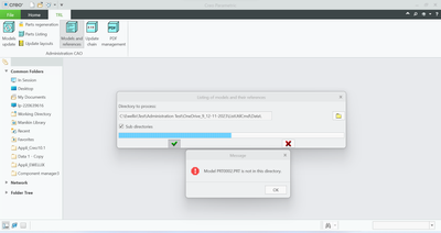

Dear all,
I Need solution to Remove "Part missing in directory" message by using creo toolkit program as shown in below image within creo toolkit features. and when program ends, I need to create log file for missing parts in directory.
Case 1-  if i have many parts, drawings in directory but for few drawings ,its linked parts are is not available in same directory then if i try to run my creo toolkit feature, it is showing "Part missing in directory" message multiple time for each and every missing parts as shown in below image. so it is creating interruption in run time.(example -if i have 10 parts missing for 10 drawings in directory then message will be populated for 10 times)
Query - can we remove this message by using creo toolkit program as shown in below image while run time and when program ends can we make its log file for missing parts ?
Condition - 1) Part name and drawing name may be same or different.
2) one drawing can have multiple parts linked.
Image -
Could you please guide me on this problem and provide me solution for it?
Many thanks in Advance.
Best Regards.

RPN
(To:VA_10882765)
Check the documentation about search path and search path file, Creo does not search the whole disc if a dependent file is not in same folder as the parent.
