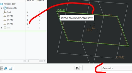

My requirement: Create a datum plane in assembly referring to a surface. Then use this datum to create a section in assembly.
I created datum plane by populating element tree.
wfcWFeature_ptr datumFeat= currSolid->WCreateFeature(elemTree, featOpts);
I get datum created correctly. Now I want to use this datum for creating section. so I query its ID by
planeID = datumFeat->GetId();  //ID i got is 43
When I create a section by
parentSOlid->CreatePlanarXSection(sectionName, planeId, cutObjtype, memberIdTable, quiltID, xtrue, compExcl);
system gives me error.
So I reselected the created datum and checked for its ID, it is 44. Now if I give this ID to above section function, it works well.
Am I missing something to differentiate between planeID and datum feature ID.
FV
(To:RS_9601780)
IDs have to be different - one is for a feature and another is for surface's ProGeomitem.
a feature has dependent geometry items or one item in case of a datum plane.
