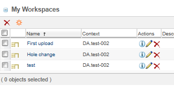

Yes, I am using wcadmin and can create a workspace ("test")

status = ProServerworkspacedataContextGet(dataitem, &context_name);//get context name gives "DA.test-002"
