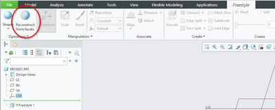

Hello All,
Is there any chance to use Quick Surface (Reverse Engineering tool) with integration to Creo Parametric 10.02.0?
Quick surface HomePage : https://www.quicksurface3d.com/

Can't you accomplish more or less the same by using the new functionality "Reconstruct from facets" in FreeStyle?
