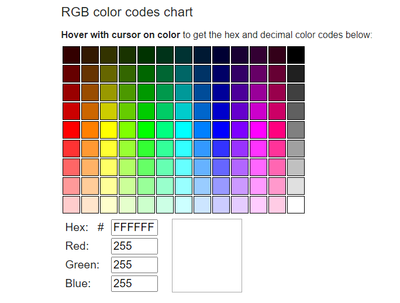

 I did finally find an example of setting up and RGB example and it was pretty simple.  With MyColor as a ProColor, I wanted to change a note to Cyan so I used the following lines to set up my Color varaiable.:
MyColor.method = PRO_COLOR_METHOD_RGB;
MyColor.value.map.red = 0;
MyColor.value.map.green = 1.0;
MyColor.value.map.blue = 1.0;
using this RGB color chart to help me figure out values,  In Creo rgb values go from 0 to 1 as opposed to 0 to 255

divide an integer value from color dialog box by maximum possible value ( double 255.0). cast result to double.
