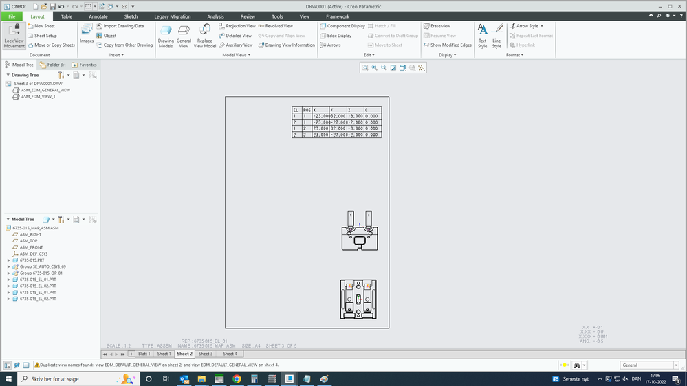

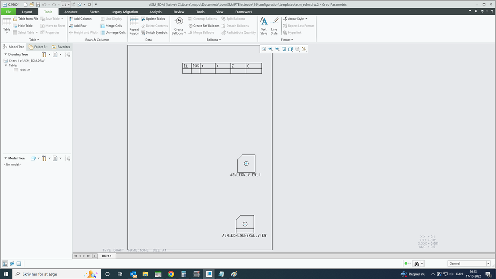

Im trying to set up the drawing templates for SmartELECTRODE, but I've got some difficulties I hope someone can help me with. The problem is when trying to add EDM positions to the drawing, using a custom (repeat region) table, it will add positions of ALL electrodes, where I only want to add the positions of the electrode on the current drawing (I've chosen option "One sheet per model"). My template looks like this:
TemplateTemplate
And this is the result:
ResultResult

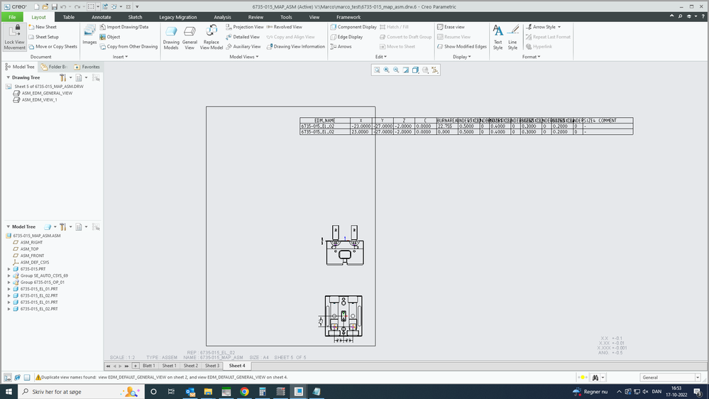

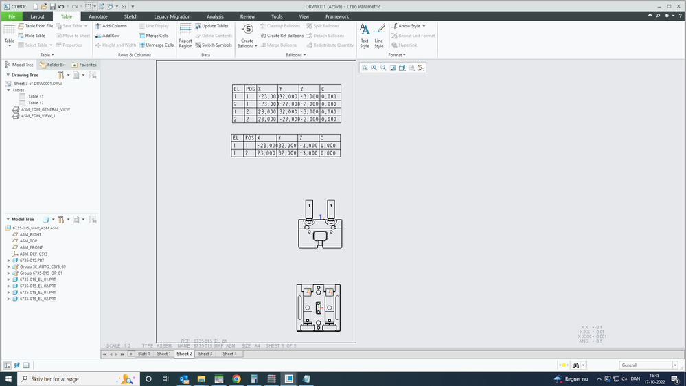

Another "weird" thing, there's probably a reason, is that when using the table from the original drawing template (see picture),
Table template in ASM_EDM standard drawingTable template in ASM_EDM standard drawing
the correct values will be added to the table. (see picture)
Result using standard drawing table.Result using standard drawing table.

EDIT: Also noticed my dimension relations are missing, unless I use the standard table template (picture 4 and 5) But I guess that could be because SmartELECTRODE never finishes making the drawings, when using a custom table.

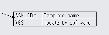

To add a custom table to your drawing, you must have the "standard table" in your drawing template. By "standard table" I mean the table that can be seen on picture 4.
So, if you are working on template drawing "asm_operation", the text in the top left corner of the table should say "asm_operation". This will load the table defined in /templates/asm_operation.tbl
I tried defining my own custom table already, but it didn't work, the table shown on picture 5 was always inserted.
But what I did wrong was having option "USE_ORIGINAL_TABLE" set to "No - The burnsheet table on drawing sheets is created by the software."
This should be set to "Yes - The burnsheet table on drawing sheets remain unchanged."
