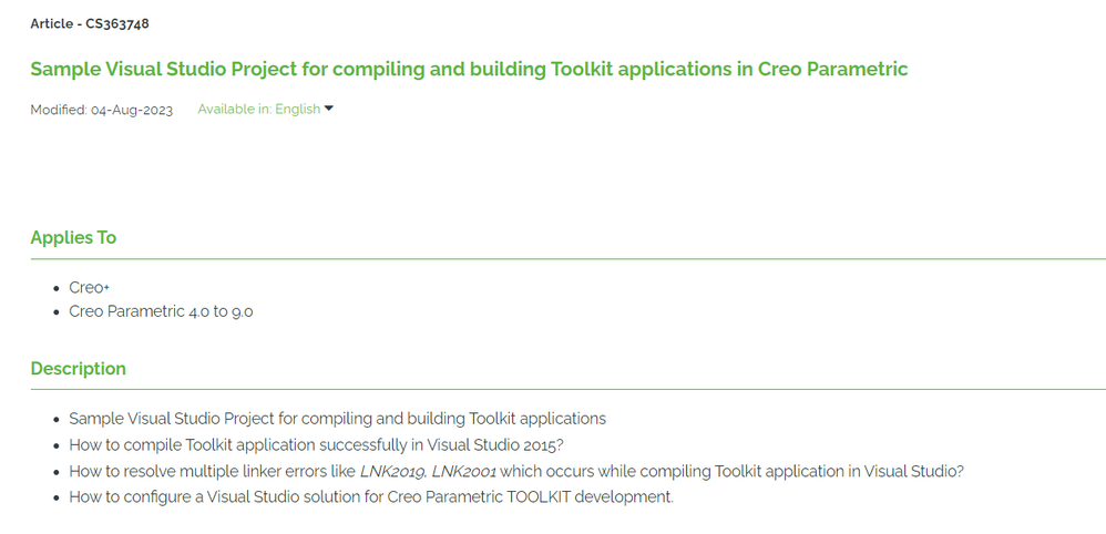

I have been trying to build the protk_install_example solution provided by PTC and facing the errors shown in the screenshots below. I am using Creo 7.0.2.0 and VS19 to build the solution. The makefile is defined as follows,

this question was raised many times before.
search for 'nmake' in community posts.
the bottom line is you have to use 'x64 native tools command prompt' shortcut from visual studio installation folder to start a command prompt on a windows machine and to run nmake -f ... command from it.
to use visual studio solution build process - visual studio project needs to be configured for use with pro/toolkit API - there is a sample visual studio solution zip archive in pro/toolkit 'obj' directory.
HIH

Thanks for the reply. I tried searching through the community before but could not find any accepted solution. I also went through your suggestions in this post. But, I am struck by your last comment that mentions running nmake from obj folder. Could you please explain where that nmake in obj folder is located? If you are referring to the toolkit installation director, I couldn't find any nmake in that location.

Before you run the PTC batch you have to make sure that the MS VC environment is initialized by a call to vcsetall.bat or something similar. After this the PTC batch will work, you may specify DLL as an argument but this is optional. Use some print statements at the beginning to make sure the vars have the  correct value.
