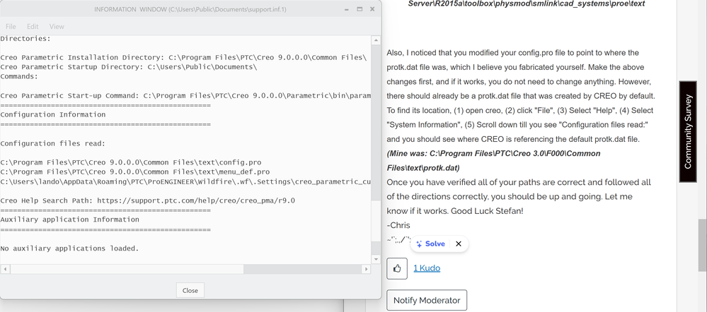

There is no protk.dat file to reference under the "Configurations files read."
LH_11210795
2-Explorer
@ChrisG I did what all you said until the end in topic. There is no protk.dat file to reference under the "Configurations files read." Do I just create a .dat file like the original commenter did or how do I go about this?
