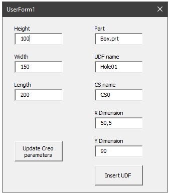

For all who would like the complete solution. This VBA function is heavily based on the VB  script by William Quintero: Original VB script Take a look at his post first! You will need it to create the initial part (Box.prt) and the used UDF. It uses the same form layout:
The following function is triggered by the "Insert UDF" button.
Private Sub btnUpdate_Click()
    Dim asyncConnection As IpfcAsyncConnection
    Dim cAC As CCpfcAsyncConnection

I also added the functions for the "Update Creo Parameters", defining the shape of the box.prt. First the function that is triggered by the "Update Creo parameters" button:
Private Sub btnInsertUDF_Click()

This function then calls for another function setting the sizes:
