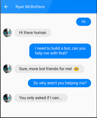

If you expect like chat bots means,
Chat botChat bot

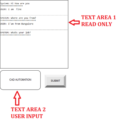

1. Create a Form
2. Place the TextArea for User input
3. Place the buttton for Submit
Whenever the user enters the input and clicks submit, get the content of text area analyze the string and update the text area with new line.

Only question is how to differentiate between two texts which are from different user... For example, a has asked and b has responded... This two things need to be differentiated and how is the query...
As I am yet to implement, would like to explore any other option available if any...

Update the user input into Text area when submit
