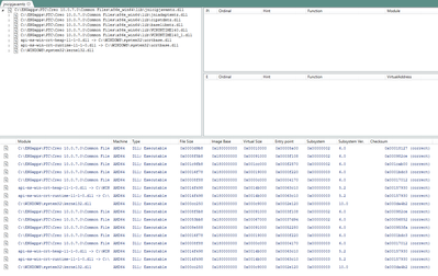

I also already ran dependent over this dll, but that didn't help:
