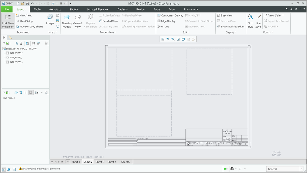

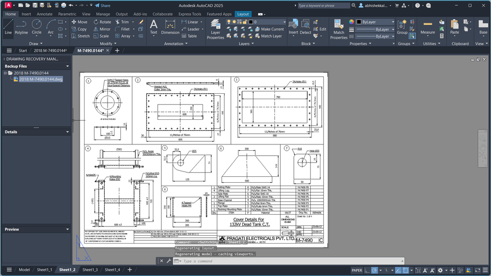

I have a question. I have attached a DWG file below. When I open it in AutoCAD, I can see the view and annotations. However, when I open it in Creo, the annotations and drawing view are not showing. Does anyone have a solution for this? What settings and configurations are needed to open a DWG file in Creo?
The DWG file is a 2013 version of AutoCAD.
this is in AutoCad
and this is in Creo

I was able to open the drawing sheets in Creo Parametric 9.
They did not have the model, just the views and dimensions.
Opening the Model Space in the DWG file, I got nothing as a drawing or part.
What are you trying to do with the file when it is moved to Creo? Using IGES or even DXF maybe a better option if you only want the drawing sheets.
