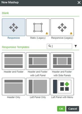

3. For Mashup Type select Responsive.
NOTE: A Responsive Mashup scales with a browser’s screen size. In the steps below we will create 5 containers, one for each widget, to organize how the widgets are presented.
4. Click OK.

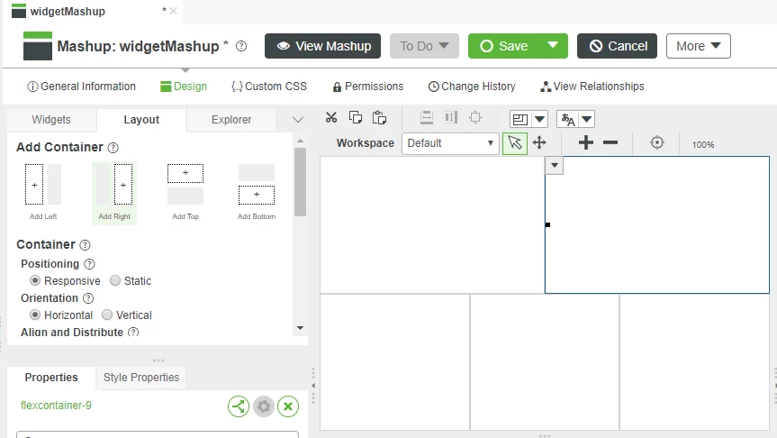

8. Select the Design tab to display Mashup Builder.
9. Select the Layout tab in the upper panel of the left dock.

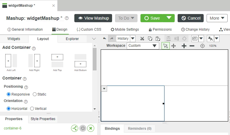

10. Click Add Bottom to split the Mashup canvas into two halves.

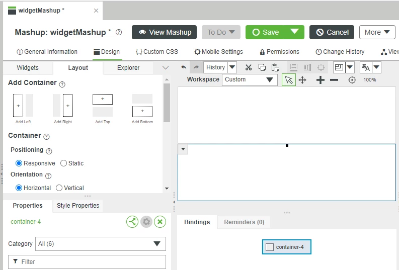

11. Click inside the bottom container to selected it, then click Add Left.
12. Click inside the bottom-right container to select it, then click Add Right.
13. Click inside the top container to select it, then click Add Right again. You should now have 5 containers in two rows, ready to have widgets added.

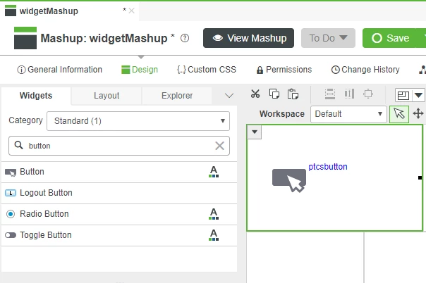

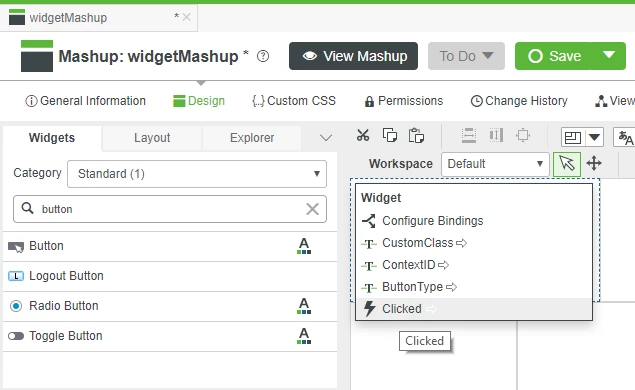

  1. Select the Widgets tab in the uppper panel of the left dock, then enter button inside the Filter field in the top-left.
  2. Drag-and-drop the Button widget onto the upper left container.

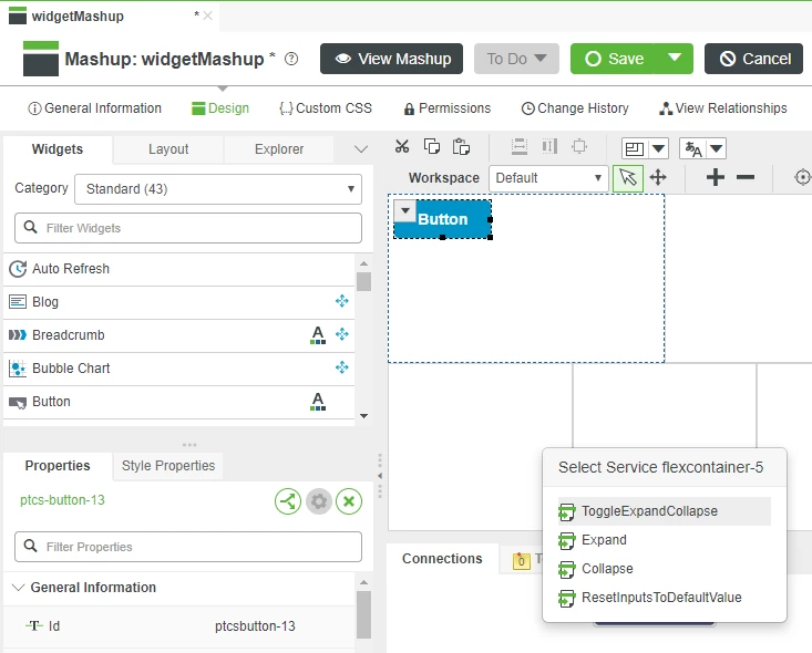

3. Click the drop-down arrow on the left side of the Button widget.
4. Click and drag the Clicked service shown in the drop-down onto a free area of the Mashup canvas.
5. When the Select Service pop-up appears, Click the ResetInputsToDefaultValues service that is provided by the Container.
6. Click Save.

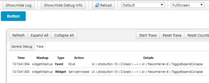

7. Click View Mashup then click Show/Hide Debug Info.
8. Click the Trace tab and click Start Trace.
9. Click the button you created in your Mashup then click Stop Trace to see the log of the Clicked event triggering the ResetInputsToDefaultValues service.
