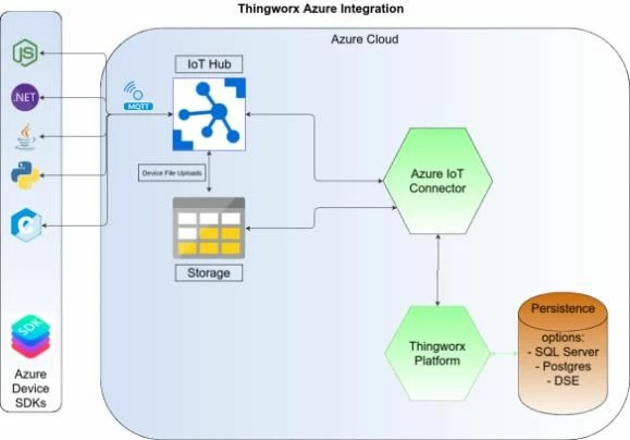

The ThingWorx Azure IoT Hub Connector maintains a network connection to both an Azure IoT and a ThingWorx Foundation instance:
The ThingWorx Azure IoT Hub Connector enables remote devices that connect to the Azure IoT Hub, to connect to the ThingWorx Foundation server. The Azure IoT Connector handles message routing for the devices that communicate through the Azure IoT system. It also handles message routing from the ThingWorx Foundation server to devices via the Azure IoT Hub.
The ThingWorx Azure IoT Connector is a separate, stand-alone application that must be run on a server that can connect to both the ThingWorx server and the Azure IoT service.

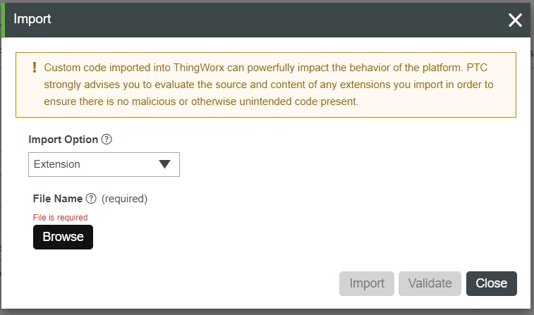

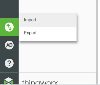

  3. In the lower-left side of Composer, click Import/Export, then Import.
  4. In the Import From File pop-up, under Import Option select Extension from the drop-down, then click Browse.
  5. Navigate to the /extensions directory and click on ConnectionServicesExtension-2.2.4.zip file.
  6. Click Import in the Import From File pop-up, then click Close after file is successfully imported.
  7. Repeat the above steps for the azure-iot-hub-adapter-extension-4.2.0.4.zip file.

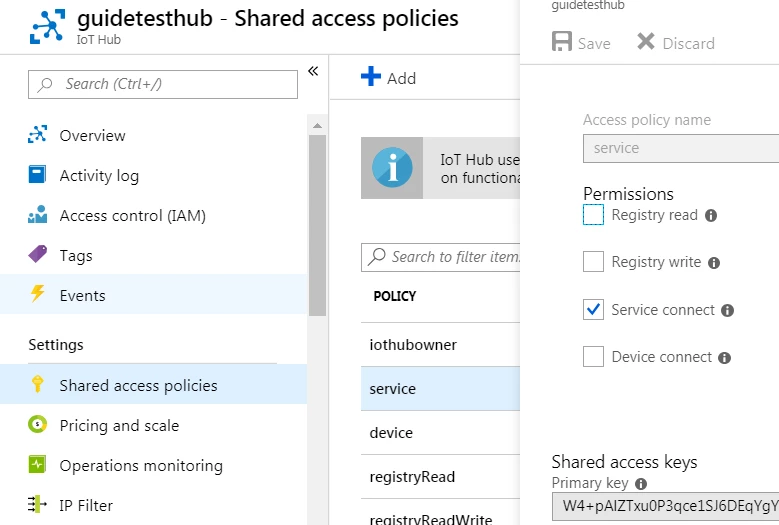

    • consumerPolicyName - Whether you have a new or existing hub, you need to provide the name of the consumer policy and its related Primary or Secondary key. The policy to select is typically the built-in, pre-defined policy called service. Navigate to All Resources > your hub > Settings > Shared access policies > service. If you added a custom service policy to your hub with the permission service connect select that policy.
    • consumerPolicyKey - Once you find the policy name, stay in the Shared access policies screen, and click the name. Copy the content of the Primary key. This key supplies the credentials to access services that are specified in the related policy.
    • registryPolicyName - Specify a policy name that is related to the registryPolicyKey. This policy is typically a built in, predefined policy called registryReadWrite, but it is possible to use a custom policy if you add it to your hub. The shared access policy requires the registry read and registry write permissions.
    • registryPolicyKey - The key that supplies credentials to access services in the policy specified in registryPolicyName.

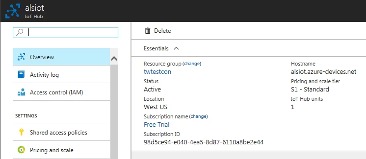

    • hubName - A name that defines the Azure IoT Hub related to this ThingWorx Connector. This Azure IoT Hub manages your things and their related messages. Hubs can be scaled via hub units at different price tiers per unit. Hubs are related to a resource group, which is related to a subscription Id and a cloud Location.
      TIP: To find the name associated with your Azure IoT Hub that the ThingWorx Connector will use to communicate with it, navigate to All Resources > your hub > Settings > Properties > NAME

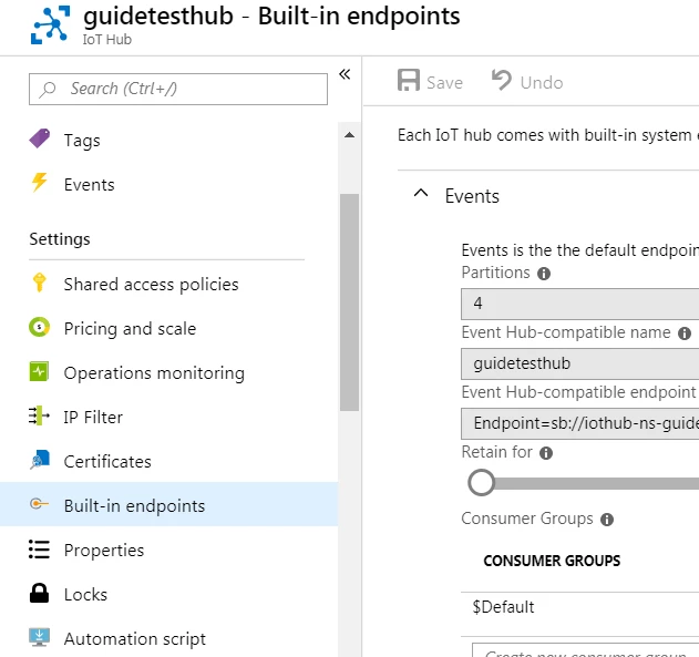

    • eventHubName - The Event Hub-compatible name that is used by SDKs and integrations that expect to read from Event Hubs. An Event Hub is an internal component of an Azure IoT Hub that handles device-to-cloud events for related things. In many cases, the IoT Hub name and Event Hubcompatible name are the same, so this property defaults to the Azure IoT Hub name (hubName). Navigate to All Resources > your hub > Settings > Built-in endpoints > Events > Event Hub-compatible name to find this name.
    • eventHubNamespace - To find the endpoint that is used by SDKs and integrations that expect to read from Event Hubs, navigate to All resources > your hub > Settings > Built-in endpoints > Events > Event Hub-compatible endpoint, and copy the host name, without the rest of the address (".servicebus.windows.net"). The ThingWorx Azure IoT Connector uses this endpoint to read messages from your hub.
    • consumerGroup - To find a consumer group name to enable the Connector to pull data from the Azure IoT Hub, navigate to All Resources > your hub > Messaging > Endpoints > Built-in endpoints > Events > Consumer groups. To use the $Default consumer group, set this property to null.
    • hubHostname - To find the host name for your hub, navigate to All Resources > your hub > Overview > Hostname. The host name is defined by the hubName plus a domain name that is chosen by Azure, typically azuredevices.net.

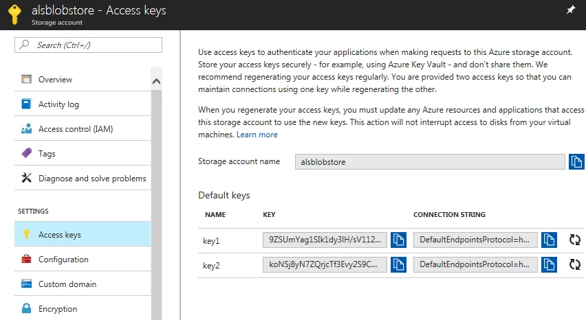

    • blob-storage.account-name - The blob-storage section specifies the settings for an Azure blob storage account. The storage provides containers that are used for device export of an Azure IoT Hub to ThingWorx via the Connector and can also be created by the Connector if you create AzureStorageContainerFileRepository things in ThingWorx. If you do not have one, create a Storage Account in the Azure portal. To find the name of an existing account, navigate to Settings > Access Keys > Storage account name.
    • blob-storage.account-key - The key to associate with the name of the blob storage account. To find the key for an existing account, navigate to Settings > Access Keys > Primary or secondary key

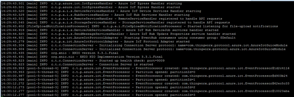

  5. The Connection Server should start with no errors or stack traces displayed. If the program ends, check the following:
    • Java version is 1.8.0, update 92 or greater and is Java(TM) not OpenJDK.
    • Open azure-iot.conf and confirm ThingWorx Foundation is set to the correct URL and port.
    • Confirm the platform scheme is ws if http is used to access ThingWorx.
    • Confirm all Azure credentials are correct for your Azure account.

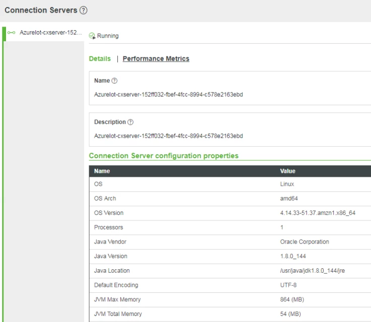

  6. In ThingWorx Foundation click the Monitoring tab then click Connection Servers. You should see a server named azure-iot-cxserver-{server-uuid}, where {server-uuid} is a unique identifier that is assigned automatically to the server.

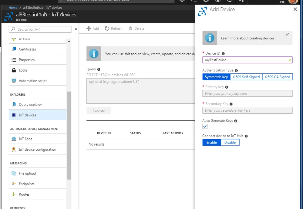

  1. In your Azure Portal, click All Resources, then select the name of your IoT Hub.
  2. Under Explorers click IoT devices, then click + Add.
  3. Enter a name for your device, then click Save.
  4. When the device name appears in the list it is ready to use.

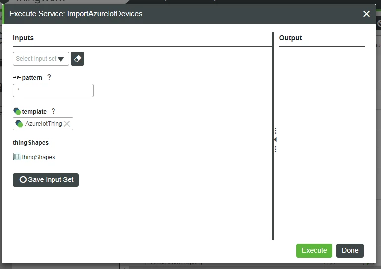

We will manually execute a service in ThingWorx that will import Azure IoT Hub devices into ThingWorx.

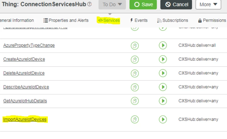

  1. In ThingWorx Composer, navigate to the ConnectionServicesHub Thing.
  2. Click Services tab and scroll to the ImportAzureIotDevices service and click the execute Arrow.
    NOTE: The * in the pattern field will act as a wildcard and import all devices, you can enter a string to match that will only import a subset of all available devices.
  3. Click Execute to import the devices then click Done.

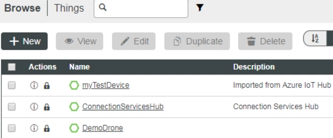

  4. Click Things in the left column to see the Things that were created.
