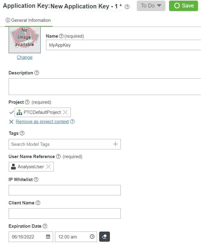

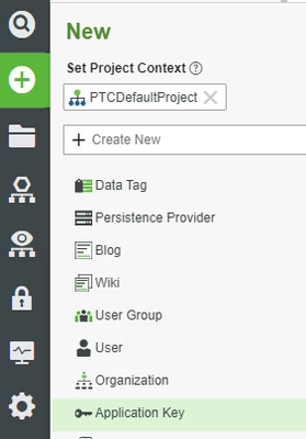

1. On the Home screen of Composer click + New.
2. In the dropdown list, click Applications Key.
3. Give your application key a name (i.e. MyAppKey).
4. If Project is not already set, click the + in the Project text box and select the PTCDefaultProject.
5. Set the User Name Reference to a User you created.
6. Update the Expiration Date field, otherwise it will default to 1 day.
7. Click Save.
A Key ID has been generated and can be used to make secure connections.

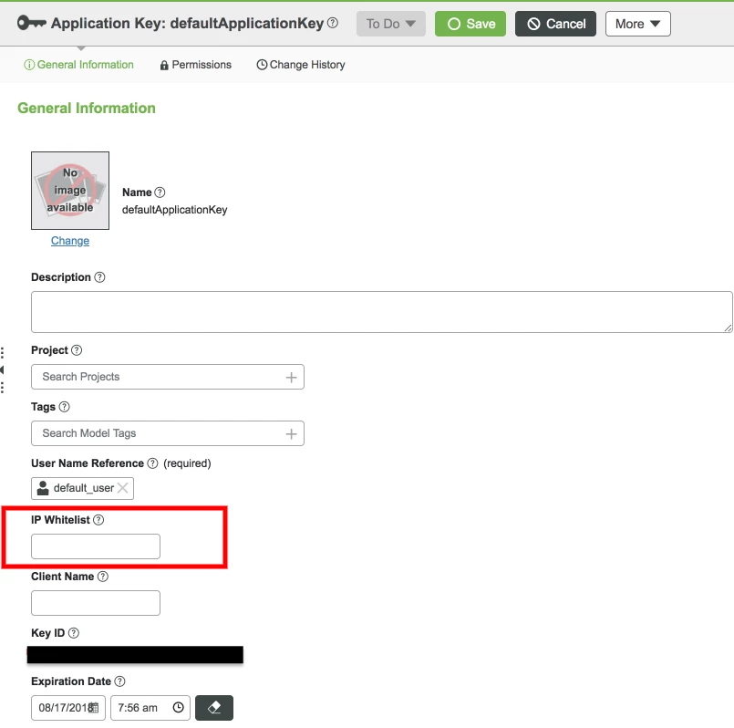

IP Whitelisting for Application Keys
One of the features of an Application Key is the ability to set an IP whitelist. This allows the server to specify that only certain IP addresses should be able to use a given Key ID for access. This is a great way to lock down security on the platform for anything that will maintain a static IP address.
For example, connected Web-based business systems may have a static IP from which all calls should be made. Similarly, you can use wildcards to specify a network to narrow the range of IP addresses allowed while still offering some flexibility for devices with dynamic IP addresses.
Extremely mobile devices should likely not attempt to implement this, however, as they will often change networks and IP addresses and may lose the ability to connect when the IP whitelist feature is used.
