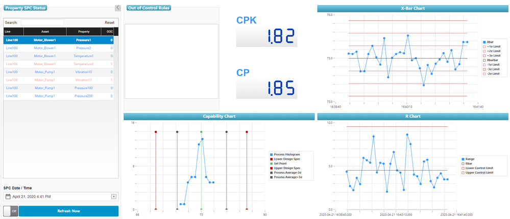

  1. Within Property SPC Status, click an item from the grid that has 0 in the OOC column.
    1. See that the Out of Control Rules area is blank, since there are no currently-violated SCP rules for that selected property.
    2. Both CP and CPK are above 1.0, showing that the process is capable.
    3. All the points in the charts are blue, as they do not violate any OOC rules.

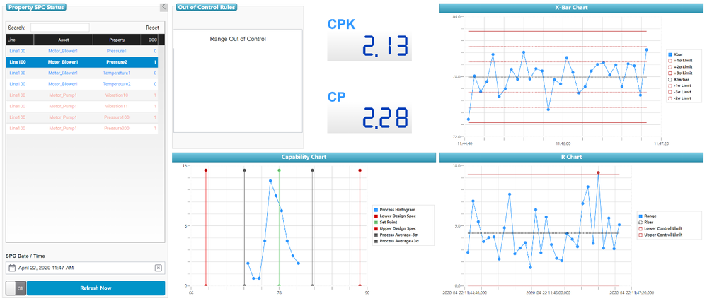

  2. Within Property SPC Status, click an item from the grid that has a nonzero number in the OOC column.
    1. See that the Out of Control Rules area has one or more rules listed that are currently being violated.
      • Here, the rule being violated is Range Out of Control.
    2. One or more of the charts may have point(s) that are red.
      • Here, you can see one of the points in the R chart is red, as it is above the Upper Control Limit.

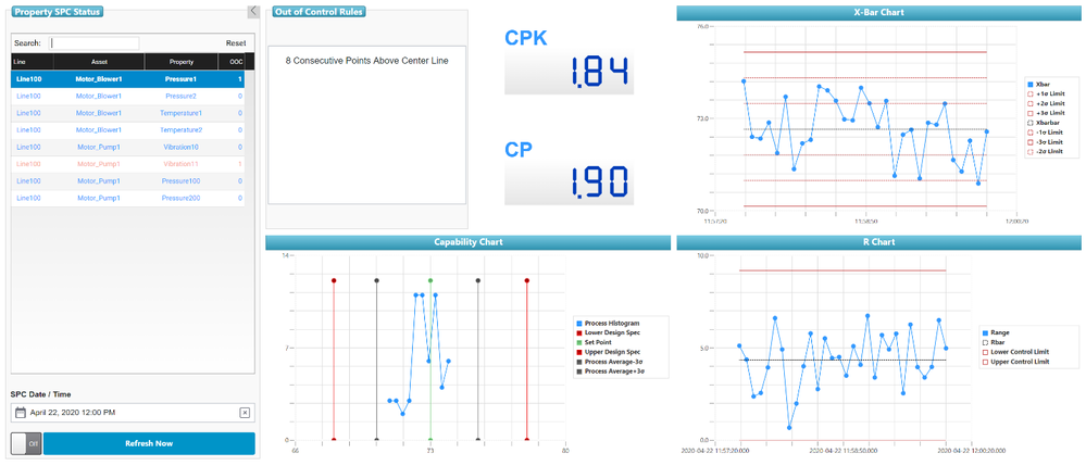

    3. Note that not all points that violate an OOC rule will display in red.

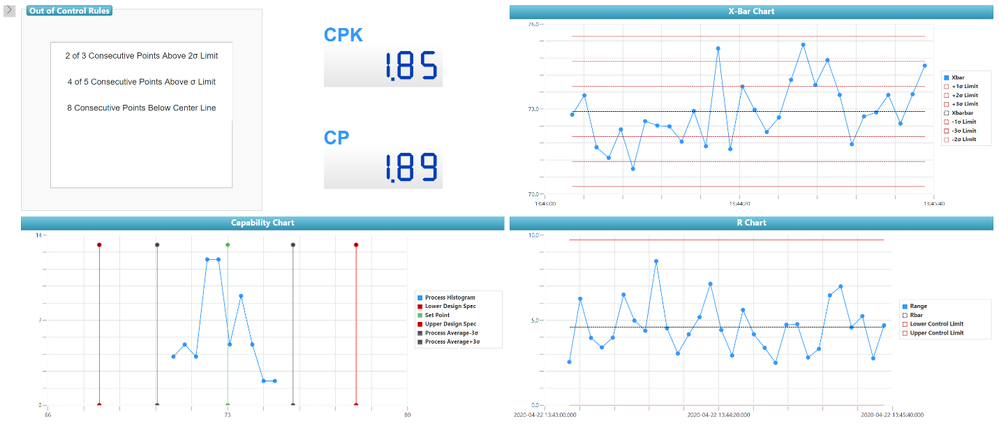

    4. Here, you can see that the rule 8 Consecutive Points Above Center Line is violated, but the corresponding points in the X-Bar Chart are not red.
