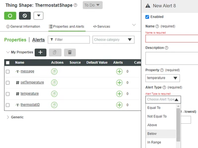

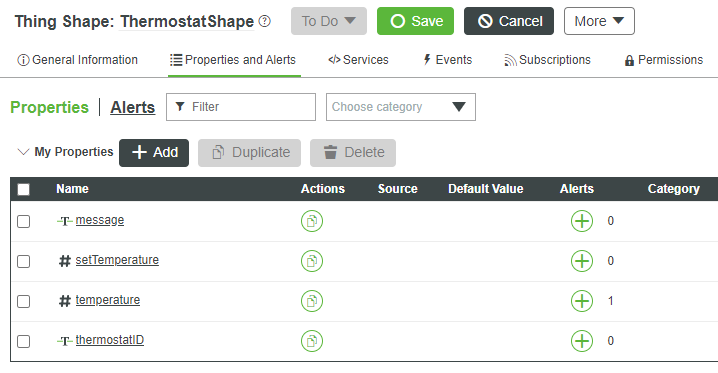

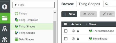

  1. Click Thing Shapes under the Modeling tab in Composer, then open the ThermostatShape Thing Shape from the list.IoTProductMgmt_0-1659623168156.png
  2. Click Properties and Alerts tab.
  3. Click the temperature property.
  4. Click the green Edit button if not already in edit mode, then click the + in the Alerts column.IoTProductMgmt_2-1659623168161.png
  5. Choose Below from the Alert Type drop down list.

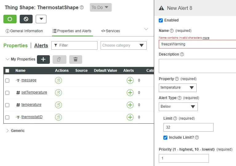

  6. Type freezeWarning in the Name field.
  7. Enter 32 in the Limit field. Keep all other default settings in place.
NOTE: This will cause the Alert to be sent when the temperature property is at or below 32.
      8. Click  button above the new alert panel.
      9. Click Save.

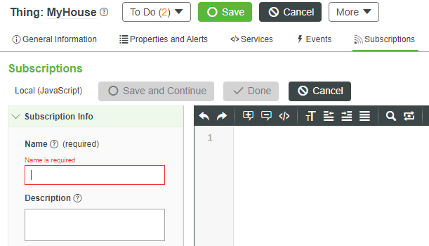

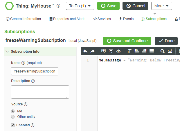

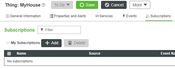

  1. Open the MyHouse Thing, then click Subscriptions tab.
  2. Click Edit if not already in edit mode, then click + Add.

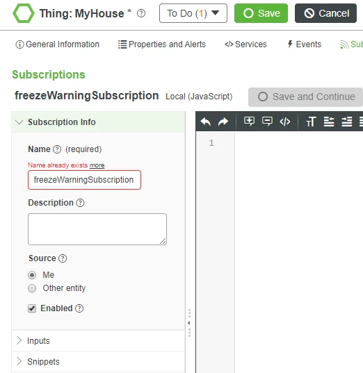

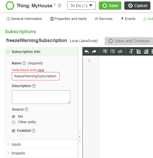

  3. Type freezeWarningSubscription in the Name field.

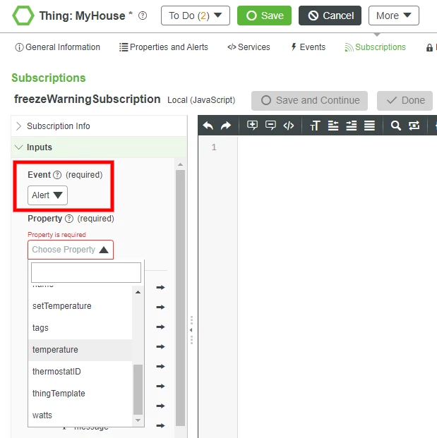

  4. After clicking the Inputs tab, click the the Event drop down list, then choose Alert.
  5. In the Property field drop down, choose temperature.
  6. Click the Subscription Info tab, then check the Enabled checkbox

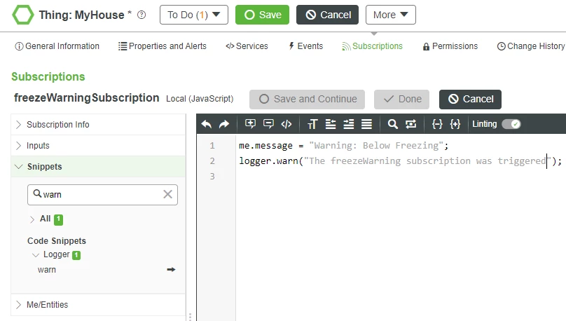

Create Subscription Code
Follow the steps below to create code that sets the message property value and writes a Warning message to the ThingWorx log.
  1. Enter the following JavaScript in the Script text box to the right to set the message property.
me.message = "Warning: Below Freezing";
2. Click the Snippets tab.
NOTE: Snippets provide many built-in code samples and functions you can use.
3. Click inside the Script text box and hit the Enter key to place the cursor on a new line.
4. Type warn into the snippets filter text box or scroll down to locate the warn Snippet.
5. Click All, then click the arrow next to warn, and Javascript code will be added to the script window.
6. Add an error message in between the quotation marks.
logger.warn("The freezeWarning subscription was triggered");
7. Click Done.
8. Click Save.

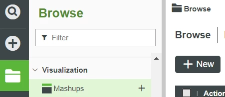

  1. Start on the Browse, folder icon tab of ThingWorx Composer.
  2. Select Mashups in the left-hand navigation, then click + New to create a new Mashup.

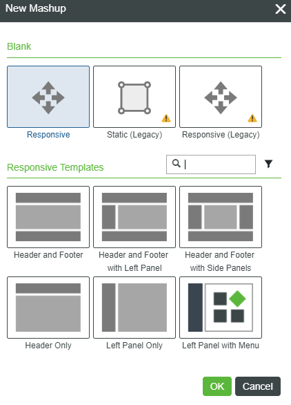

  3. For Mashup Type select Responsive.
  4. Click OK.

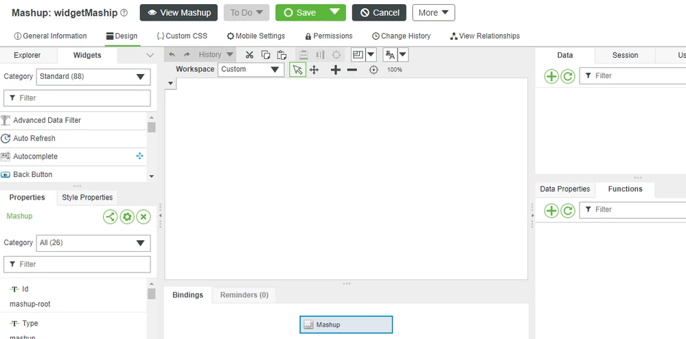

  5. Enter widgetMashup in the Name text field,
  6. If Project is not already set, click the + in the Project text box and select the PTCDefaultProject,
  7. Click Save.

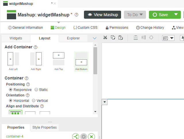

  8. Select the Design tab to display Mashup Builder.IoTProductMgmt_13-1659623168177.png

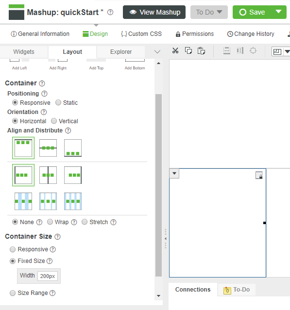

Organize UI
  1. On the upper left side of the design workspace, in the Widget panel, be sure the Layout tab is selected, then click Add Bottom to split your UI into two halves.IoTProductMgmt_14-1659623168179.png
  2. Click in the bottom half to be sure it is selected before clicking Add Left
  3. Click anywhere inside the lower left container, then scroll down in the Layout panel to select Fixed Size
  4. Enter 200 in the Width text box that appears, then press Tab key of your computer to record your entry.
  5. Click Save

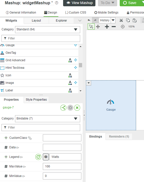

Step 9: Add Widgets

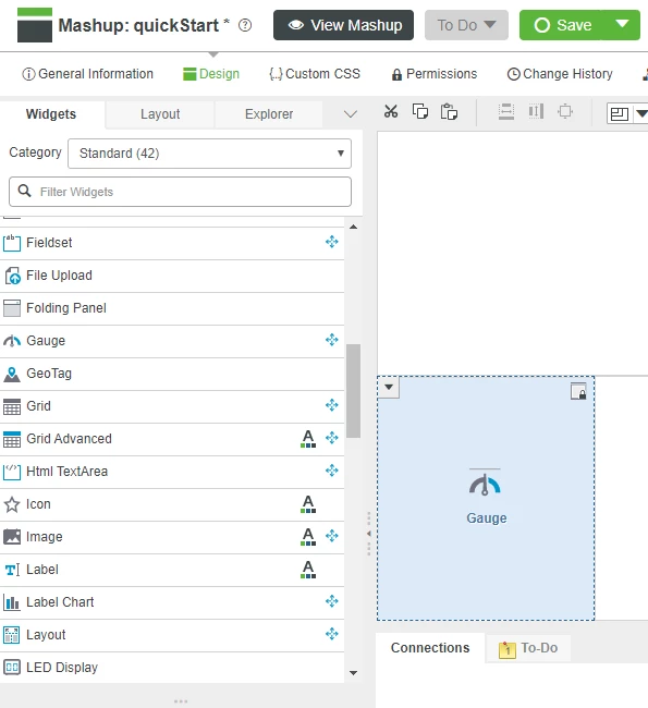

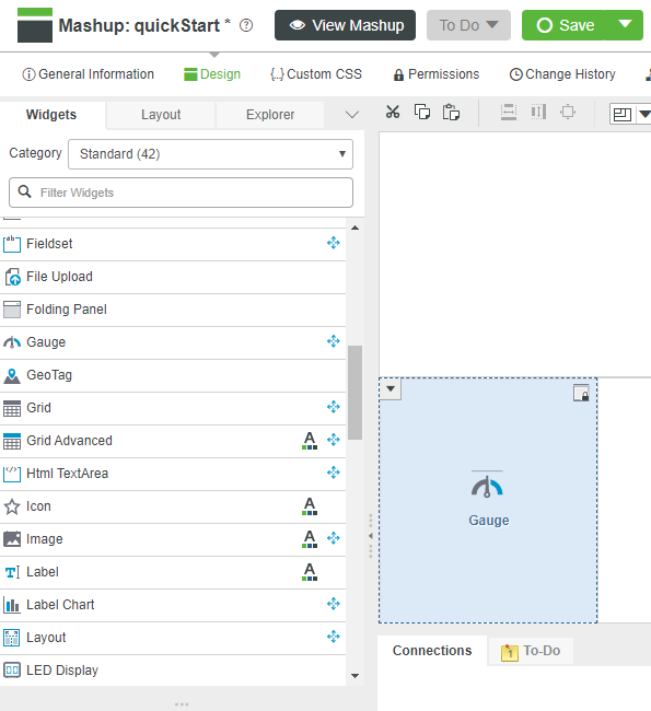

  1. Click the Widgets tab on the top left of the Widget panel, then scroll down until you see the Gauge Widget
  2. Drag the Gauge widget onto the lower left area of the canvas on the right. This Widget will show the simulated watts in use.IoTProductMgmt_16-1659623168182.png
  3. Select the Gauge object on the canvas, and the bottom left side of the screen will show the Widget properties.
  4. Select Bindable from the Catagory dropdown and enter Watts for the Legend property value, and then press tab..IoTProductMgmt_17-1659623168184.png

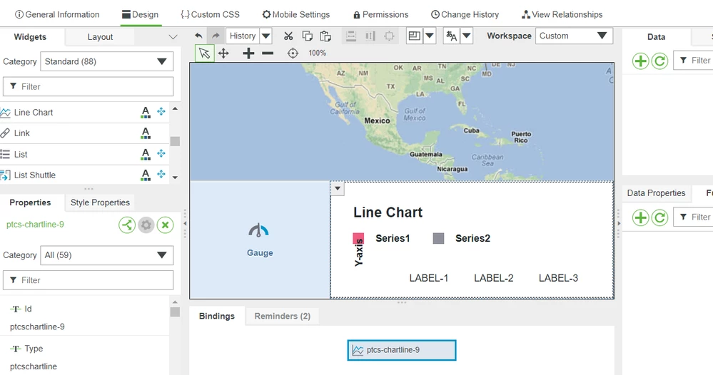

  5. Click and drag the Google Map Widget onto the top area of the canvas.
NOTE: The Google Map Widget has been provisioned on PTC CLoud hosted trial servers. If it is not available, download and install the Google Map Extension using the step-by-step guide for using Google Maps with ThingWorx .
6. Click and drag the Line Chart Widget onto the lower right area of the canvas.
7. Click Save
