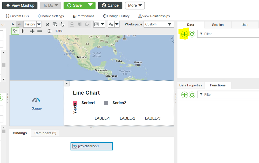

  1. Click the Data tab in the top-right section of the Mashup Builder.
  2. Click on the green + symbol in the Data tab.IoTProductMgmt_0-1659628881678.png

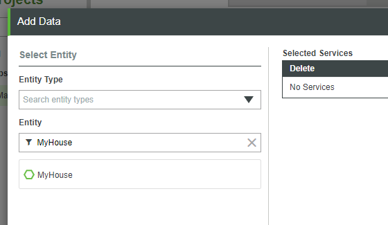

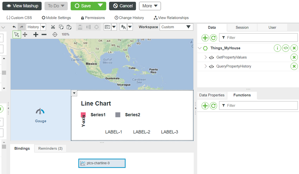

  3. Type MyHouse in the Entity textbox.
  4. Click MyHouse.

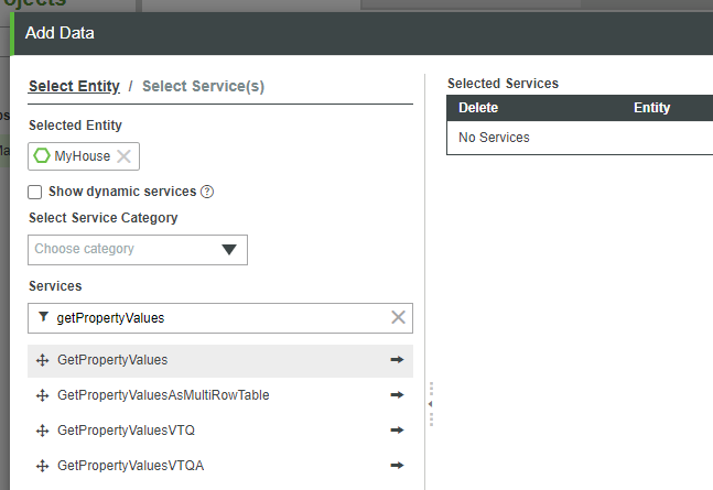

  5. In the Filter textbox below Services, type GetPropertyValues.
  6. Click the arrow to the right of the GetPropertyValues service to add it.IoTProductMgmt_2-1659628881681.png
  7. Select the checkbox under Execute on Load.
NOTE: If you check the Execute on Load option, the service will execute when the Mashup starts.

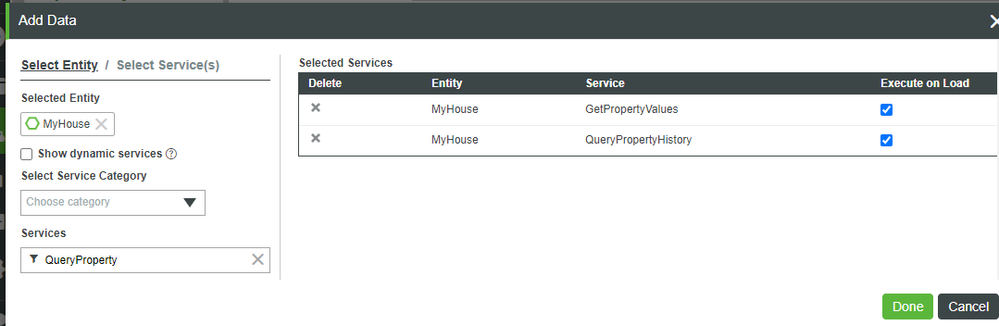

8. In the Filter textbox under Services, type QueryProperty.
9. Add the QueryPropertyHistory service by clicking the arrow to the right of the service name.IoTProductMgmt_3-1659628881682.png
10. Click the checkbox under Execute on Load.
11. Click Done.
12. Click Save.

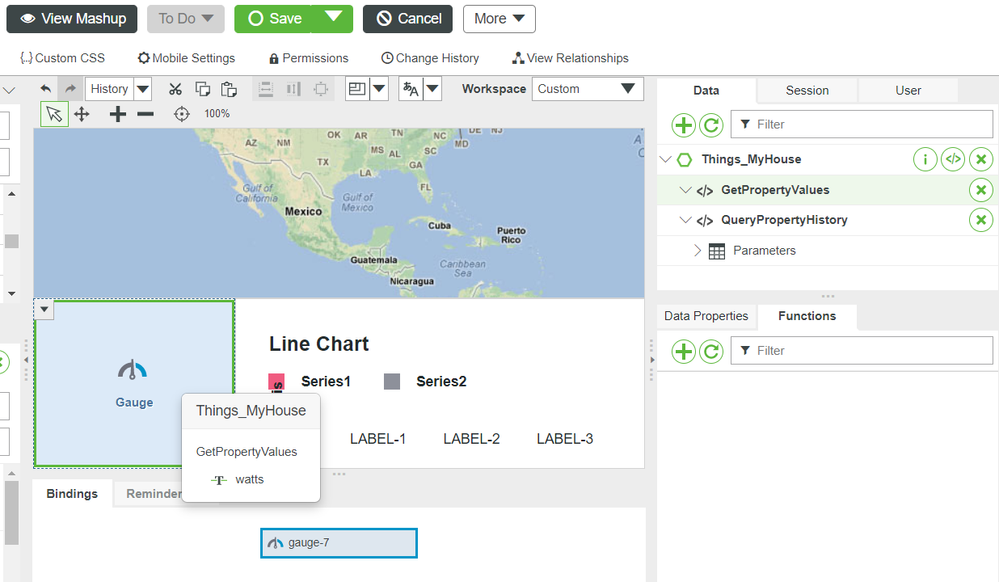

Gauge
Configure the Gauge to display the current power value.
  1. Expand the GetPropertyValues Service as well as the Returned Data and All Data sections.
  2. Drag and drop the watts property onto the Gauge Widget.IoTProductMgmt_5-1659628881701.png
  3. When the Select Binding Target dialogue box appears, select # Data.

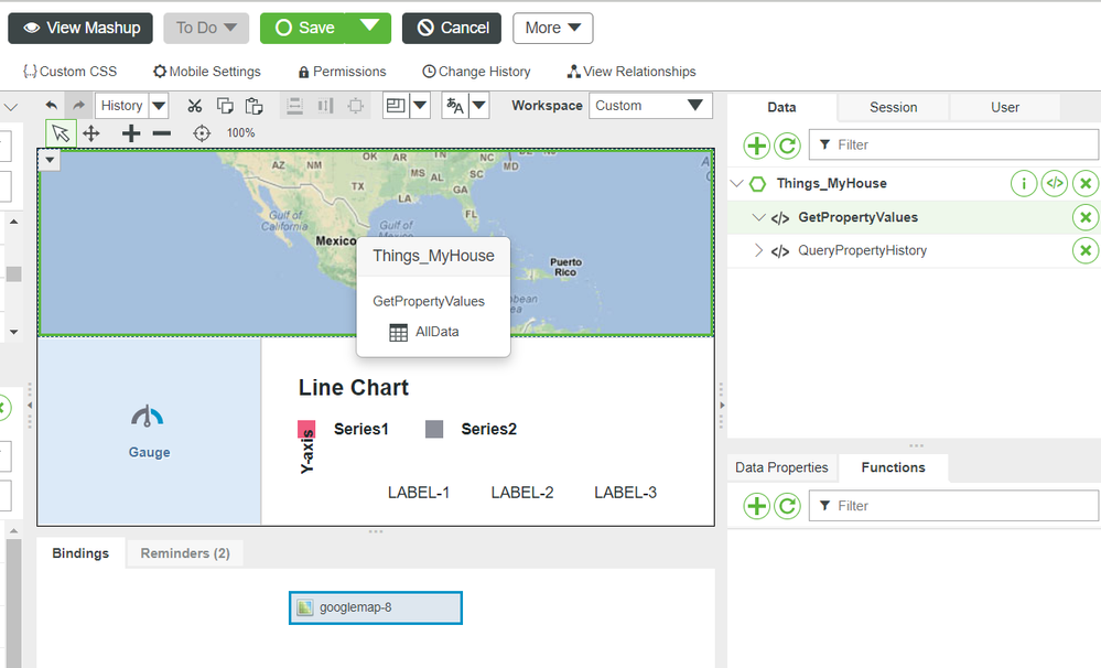

  1. Expand the GetPropertyValues service as well as the Returned Data section.
  2. Drag and drop All Data onto the map widget.IoTProductMgmt_6-1659628881710.png
  3. When the Select Binding Target dialogue box appears, select Data.

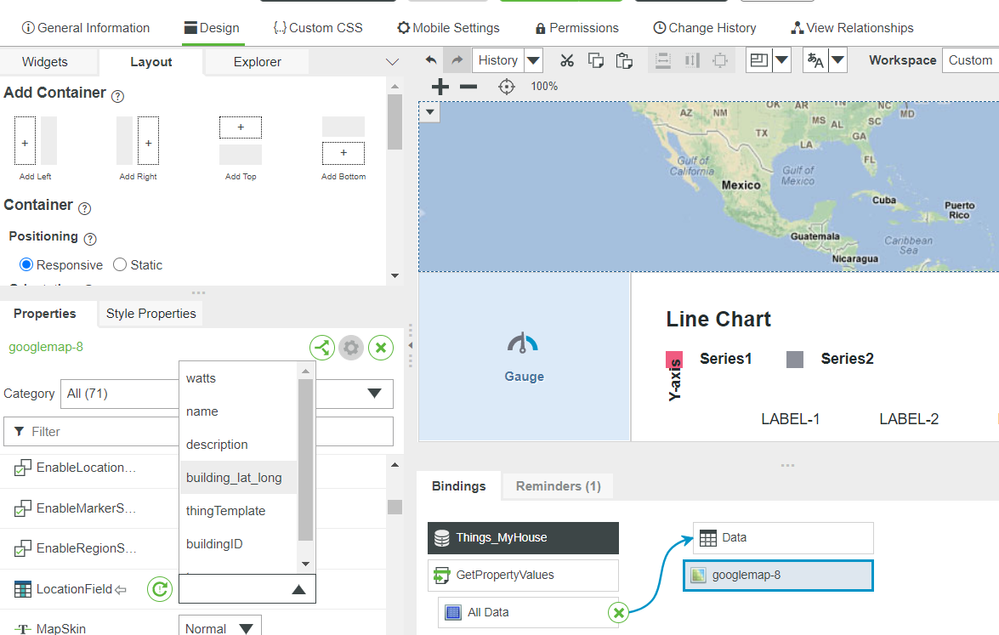

  4. Click on the Google Map Widget on the canvas to display properties that can configured in the lower left panel.
  5. Set the LocationField property in the lower left panel by selecting building_lat_lng from the drop-down menu.IoTProductMgmt_7-1659628881719.png

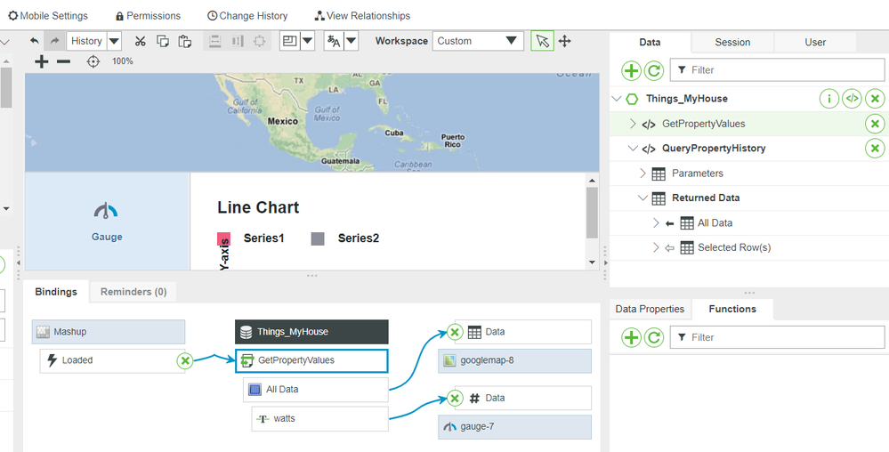

Verify Data Bindings
You can see the configuration of data sources bound to widgets displayed in the Connections pane.
  1. Click on GetPropertyValues in the data source panel then check the diagram on the bottom of the screen to confirm a data source is bound to the Gauge and Map widget.IoTProductMgmt_9-1659628881735.png
  2. Click on the QueryPropertyHistory data source and confirm that the diagram shows the Chart is bound to it.

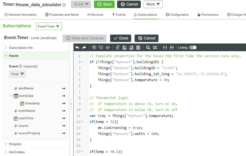

At this point, you have created a Value Stream to store changing property value data and applied it to the BuildingTemplate. This guide does not include connecting edge devices and another guide covers choosing a connectivity method. We will import a pre-made Thing that creates simulated data to represent types of information from a connected home. The imported Thing uses Javascript code saved in a Subscription that updates the power and temperature properties of the MyHouse Thing every time it is triggered by its timer Event.
Import Data Simulation Entities
  1. Download the attached sample:  Things_House_data_simulator.xml.

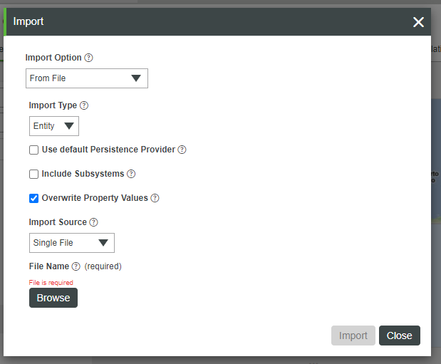

  2. In Composer, click the Import/Export icon at the lower-left of the page.
  3. Click Import.
  4. Leave all default values and click Browse to select the Things_House_data_simulator.xml file that you just downloaded.
  5. Click Open, then Import, and once you see the success message, click Close.
Explore Imported Entities

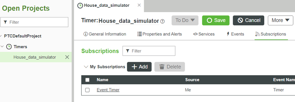

  1. Navigate to the House_data_simulator Thing by using the search bar at the top of the screen.
  2. Click the Subscriptions tab.
  3. Click Event.Timer under Name.
  4. Select the Subscription Info tab.
NOTE: Every 30 seconds, the timer event will trigger this subscription and the Javascript code in the Script panel will run. The running script updates the temperature and watts properties of the MyHouse Thing using logic based on both the temperature property from MyHouse and the isACrunning property of the simulator itself.
5. Expand the Subscription Info menu. The simulator will send data when the Enabled checkbox is checked.
6. Click Done then Save to save any changes.

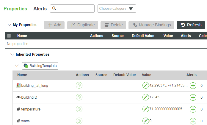

  1. Open the MyHouse Thing and click Properties an Alerts tab
  2. Click the Refresh button above where the current property values are shownIoTProductMgmt_14-1659628881743.png
  3. Notice that the temperature property value changes every 30 seconds when the triggered service runs. The watts property value is 100 when the temperature exceeds 72 to simulate an air conditioner turning on.

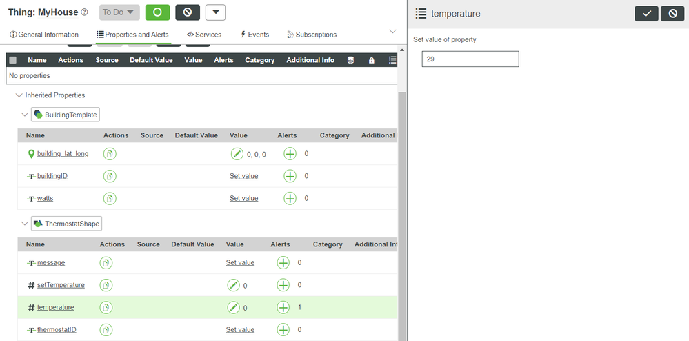

Test Alert

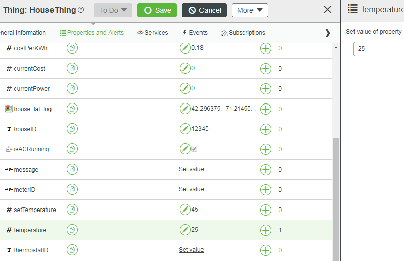

  1. Open MyHouse Thing
  2. Click the Properties and Subscriptions Tab.
  3. Find the temperature Property and click on pencil icon in the Value column.
  4. Enter the temperature property of 29 in the upper right panel.
  5. Click Check mark icon to save value. This will trigger the freezeWarning alert.IoTProductMgmt_17-1659628881775.png
  6. Click Refresh to see the value of the message property automatically set.IoTProductMgmt_18-1659628881777.png

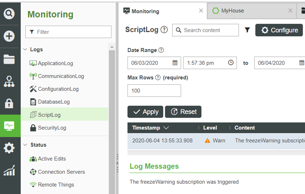

7. Click the the Monitoring icon on the left, then click ScriptLog to see your message written to the script log.
