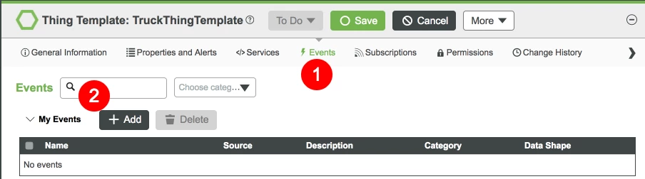

Follow the steps below to create an Event for the TruckThingTemplate Entity.
  1. Open the TruckThingTemplate Entity and click the Events tab.
  2. Click Add.

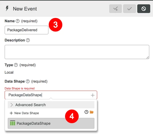

  3. Enter an Event name, such as PackageDelivered.
  4. For the DataShape, in the Search Data Shape field, filter and select PackageDataShape.
Events can be queued or fired based on updates done in Composer, property changes of a running application, or programmatically. Triggering or firing an Event can be done in Services utilizing JavaScript.

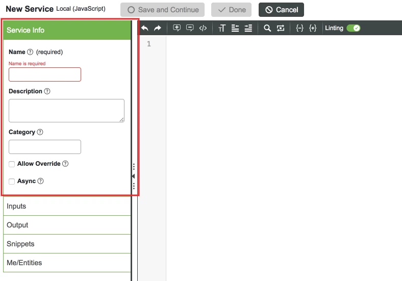

Service Info Tab
This tab is for the general information of the Service. This is where you will add the Service name, description, category, whether the service is asynchronous, and whether the Service can be overridden.

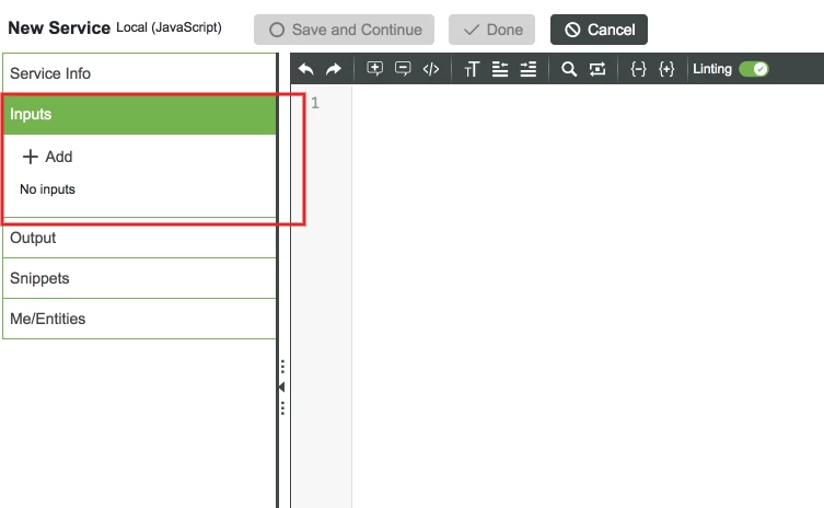

Inputs Tab
This tab is for the parameters for the Service. For input parameters, a parameter can be required and default values are allowed.

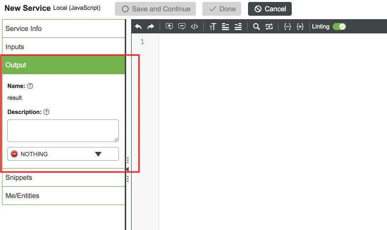

Outputs Tab
This tab is for the return type of the Service. The resulting output of the Service can stretch from being nothing to user defined Entities.

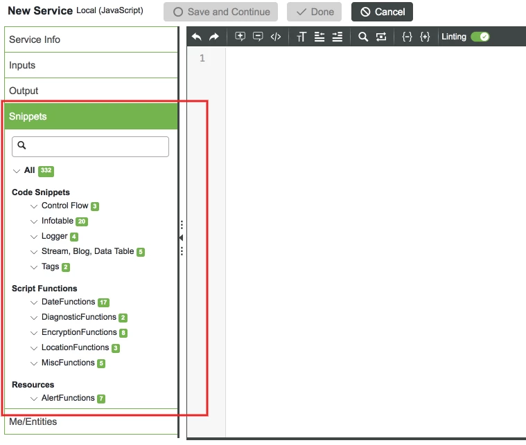

Snippets Tab
This tab allows users to pick from reusable JavaScript code that is specific to ThingWorx. These snippets are grouped by resources used, functionality, and type. You are also provided a search bar to look for keywords or titles.
When a snippet is found, click the arrow. This will insert the JavaScript code into the Script section wherever the cursor is located. From here, edit the inserted snippet to work with the rest of your code. This section is often helpful in getting to know how to perform service calls and code for the ThingWorx environment.

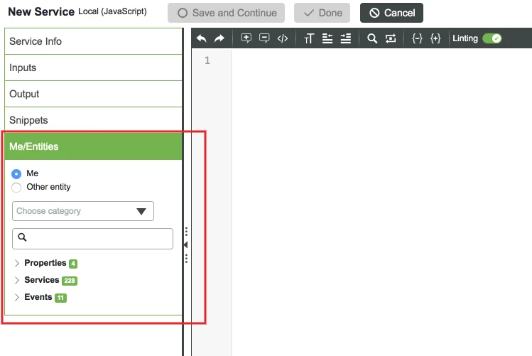

Me/Entities Tab
A listing of all Properties, Events, and Services belonging to custom and provided Entities in ThingWorx. As with the Snippets section, clicking the blue and white arrow will insert the reusable code to wherever the cursor is located. After the code is inserted, update the code to your liking. This is often a great resource for buildiung up payload for Service calls.
