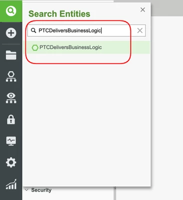

  1. On the home page, filter and select the PTCDeliversBusinessLogic Thing.

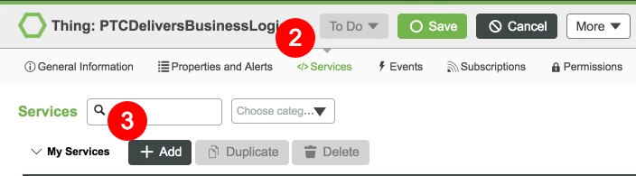

  2. Switch to the Services tab.
  3. Click + Add.

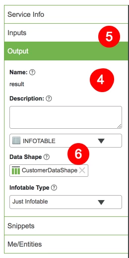

  5. Switch to the Output tab of the Service.
  6. Select InfoTable from the list as the Base Type. When prompted for the DataShape, select CustomerDataShape.

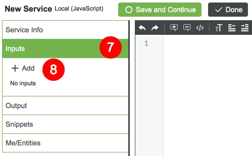

  7. Switch to the Inputs tab of the Service.
  8. Click the + Add button.

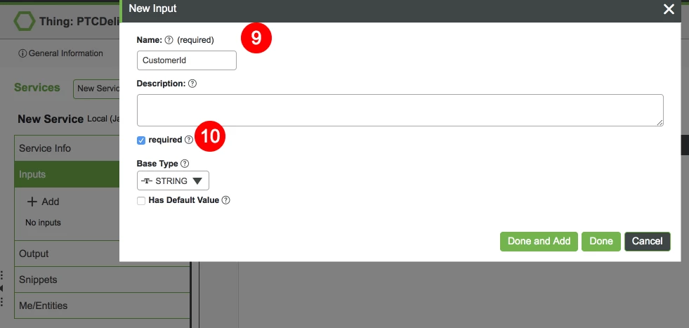

  9. Enter the name CustomerId.
  10. Check the Required checkbox.
  11. Click Done.

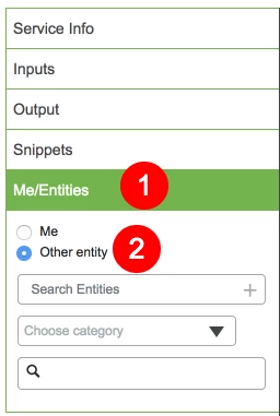

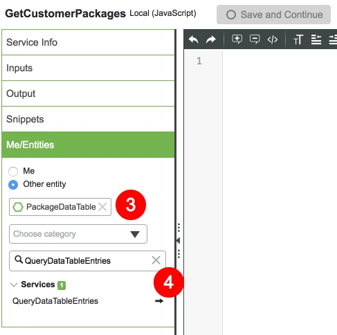

  1. Switch to the Me/Entities tab.
  2. Switch the radio option to Other Entity.
  3. Filter and select PackageDataTable as the Entity. A list of all accessible Services for the PackageDataTable will appear.
  4. In the search bar for Services, enter QueryDataTableEntries in the Services section and click the arrow next to it.
  5. Update the inserted code to use the input parameter, CustomerId, in the query. An example is below and more information can be found on queries on our Query Help Page.

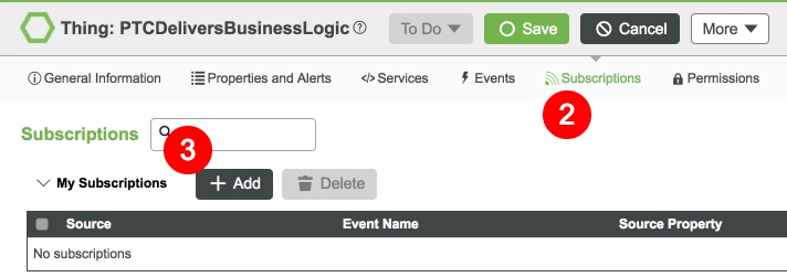

  2. Switch to the Subscriptions tab.
  3. Click + Add.

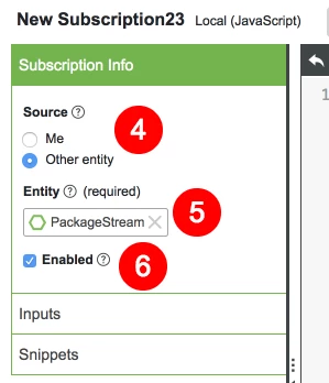

  4. For Source, select *Other Entity.
  5. Filter and select PackageStream.
  6. Check the Enabled checkbox.
    Using a Stream to track events in the application allows for one source to watch for activity. The source for a Subscription can be other Entities if a single Entity is wanted. In order to capture all source data from the PackageStream, you will need to set it as the Stream for the Entity you would like to track.

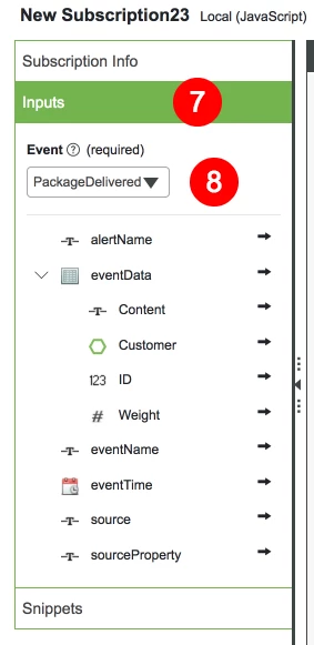

  7. Switch to the Inputs tab.
  8. Select the Event drop-down and pick the PackageDelivered Event. This PackageDelivered Event only exists in the completed download. If you are not using that download, create your own Event based on the PackageDataShape.
