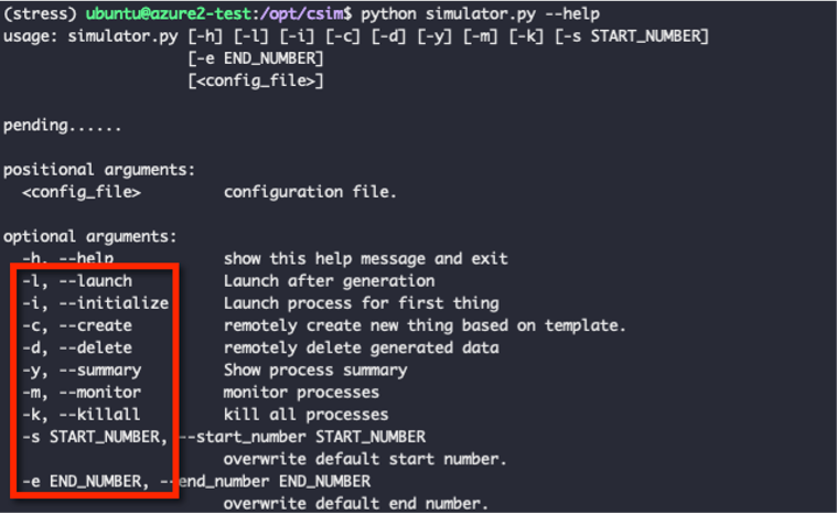

  7. Familiarize yourself with the simulator.py file and its options
    Use the following command to get option information:
    python simulator.py --help​
