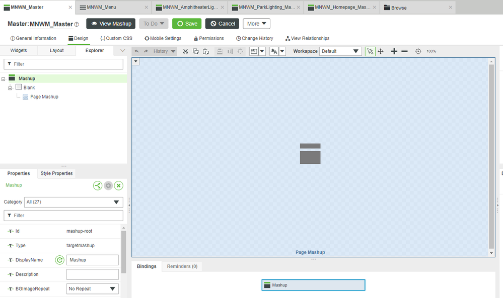

Step 6: Create Master
Now that we have created our Menu Entity, we can create a Master Mashup to hold a Menu Widget. We'll use the Menu Entity to configure the Menu Widget.
- Navigate to Browse > Visualization > Masters.
- Click +New.
- Leave the defaults and click OK.
- In the Name field, type MNWM_Master.
- If Project is not already set, search for and select PTCDefaultProject.
- At the top, click Save.
- At the top, click Design.
Add Header
Now that we've created the Master Entity, we need to add space for the Menu Widget.
- At the top-left, click the Layout tab.
- Click Add Top.
- With the new top-section still selected, scroll down in the Layout tab, and select Container Size > Fixed Size.
- In the new Height field, type 50, then hit your keyboard's Tab key to apply the change.
Add Menu Widget
Now that we have somewhere to put it, we can finally add the Menu Widget and then configure it.
- In the top-left, click the Widgets tab.
- Drag-and-drop a Menu Widget onto the top Canvas section.
- Ensure the Menu Widget is still selected, as well as the Properties tab in the bottom-left.
- In the Filter field, type menu.
- For the Menu Property, search for and select MNWM_Menu.
