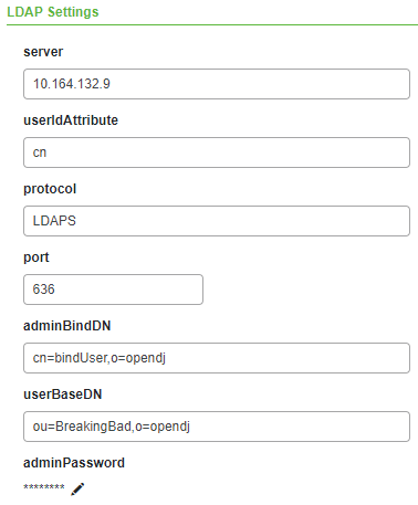

ThingWorx Composer
- As the IP address is used (the hostname is not mapped in Docker container) the certificate must have a SAN containing the IP address
![image image](/t5/image/serverpage/image-id/63775iFAB8B9896655EF9D/image-size/large?v=v2&px=999)
- Only works with the TWLDAPExample Directory Service not the ADDS1, because ADDS1 uses hard coded Active Directory queries and structures and therefore does not work with OpenDJ.
- User ID (cn) must be pre-created in ThingWorx, so the user can login. There is no automatic user creation by the Directory Service.
- Make sure the Thing is Enabled under General Information
