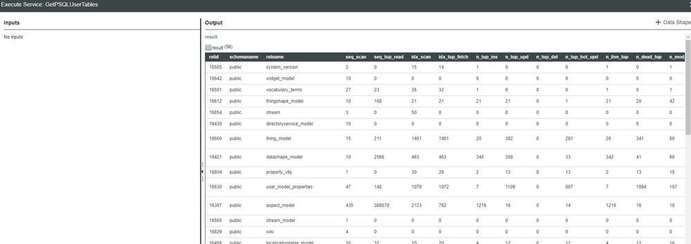

17. GetPSQLUserTables
- Fetches all the user created tables, together with their
  • name, OID
  • Disk I/O
  • Last auto vacuum , vacuum
  • Also lists the amount of rows each relation (table) has
